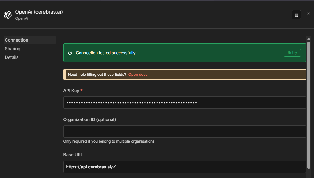

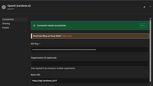

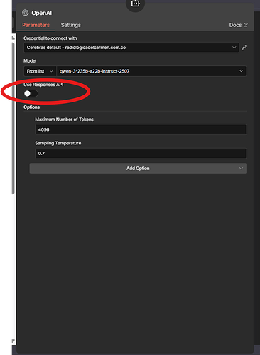

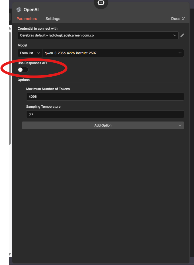

You were spot on. I had actually tried the OpenAI node before, but it kept hanging, so I assumed it wasn’t compatible.
It turns out the culprit was the “Use Responses API” toggle. I had it ON, and that breaks the connection with Cerebras. Turning it OFF fixed everything immediately. Thanks for the nudge!

The Fix:
Simply switch your AI Agent node back to Version 2.
Combined with the OpenAI Chat Model node (Base URL: https://api.cerebras.ai/v1, “Use Responses API”: OFF), everything works 100% natively. No custom code needed.
