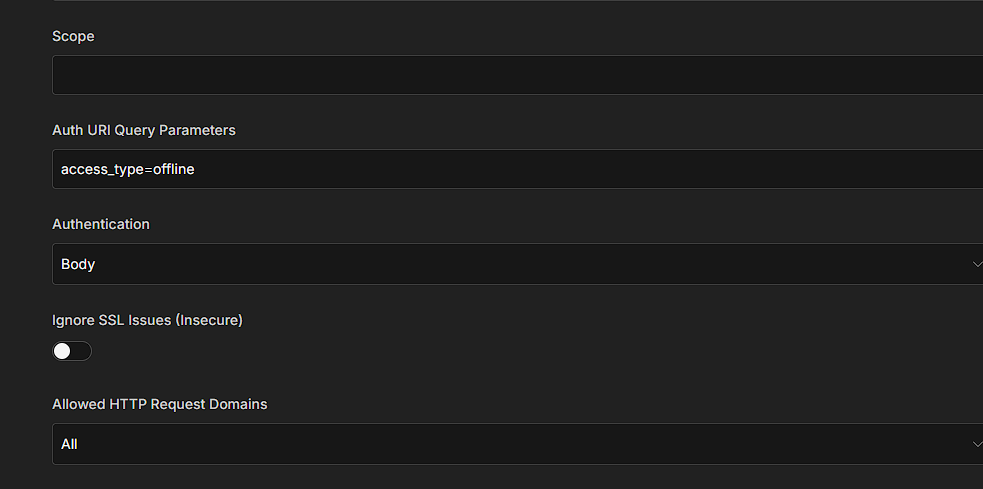

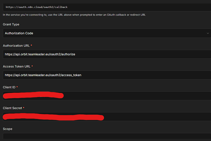

  2. Screenshot of your OAuth2 credential config (pls hide secrets)?
  3. Does the initial OAuth connection work, or does it fail immediately?
    • It definitely works but after 24 hours, the token expires and the workflow fails
