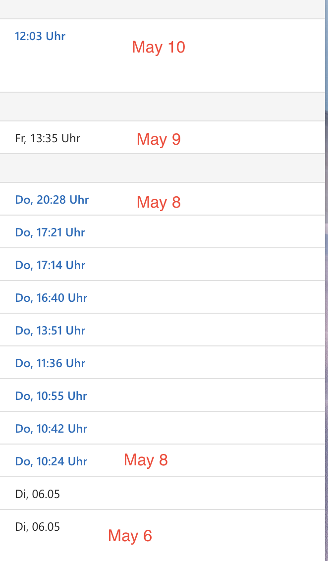

Do you also have the problem that workflows are not triggered at irregular intervals (in active mode)?
-The trigger/workflow works in test mode
-The trigger/workflow works in normal mode (tested)
I have a workflow that is triggered when an invoice mail (Outlook) is moved to an “Invoice” folder. This also works when I try it out (in test mode and in normal mode), but I have now noticed several times that I have mails in the folder that do not trigger the workflow, but since it normally works, all settings are basically correct. It’s not as if I have an email every 10 seconds, sometimes these emails arrive with a time delay of several hours…
In the screenshots you can see that emails arrive regularly, but the workflow is hardly ever triggered.

Thanks for the input!
I personally don’t think it’s a rate limit issue in my case. As you can see in the screenshot, the emails are coming in with large time gaps — sometimes several hours apart. Even on the more active days, the messages are spaced out enough that they shouldn’t exceed any typical API rate limits. From what I understand, rate limits usually apply when multiple requests are made within seconds or a short period, which doesn’t match my situation.
So I think the issue might be elsewhere — possibly with how the event triggers are handled on the Microsoft side or with n8n’s connection stability.
