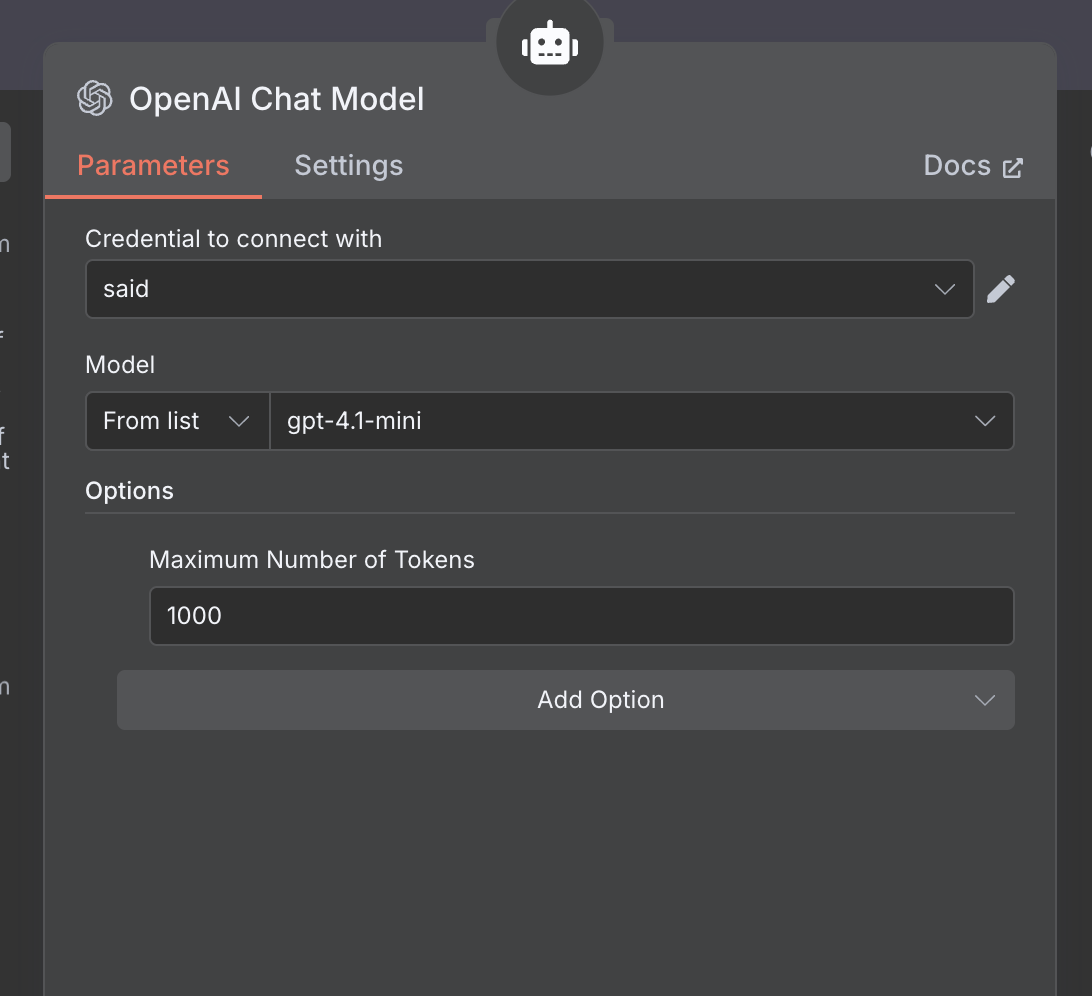

hi there @gorgle_fornel ,on the openAI chat model there’s an option to limit the maximum number of tokens for it to consume on 1 execution
i think u can use tht to limit how many tokens used per execution

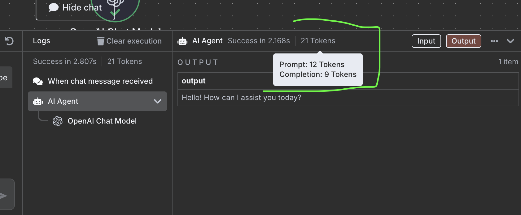

also, are you sure that the token is drained out because of the prompting and not because other stuff
you can make sure of this by test executing the workflow and see on the logs how much token does it take
like this one
