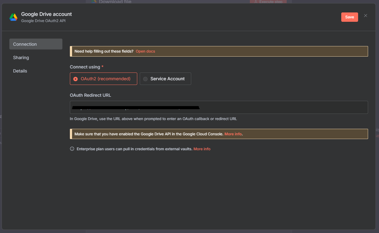

Hi everyone! I’m facing an issue creating Google credentials and using the respective nodes. When I try to create a credential using OAuth2 connection for Google Drive, essential fields like Client ID and Client Secret don’t appear in the interface, as shown in the attached image. Without these fields, I can’t complete the authentication process. Has anyone experienced this before or have any suggestions?

I already have the credentials created in Google. The problem is that in N8N, the fields to input these credentials don’t appear.
Yes, my domain points to my server. And yes, my URL is https.
I have additional information about this case. When I open the node editor to create the credential, the fields to input the credentials appear for a fraction of a second and then disappear. I believe this might be a bug or some permission issue.
If you have the following env variable in your docker run command or docker compose file: N8N_DEFAULT_LOCALE remove it and restart the server.
It worked!!
Thanks so much, bro, you saved my life!!!
