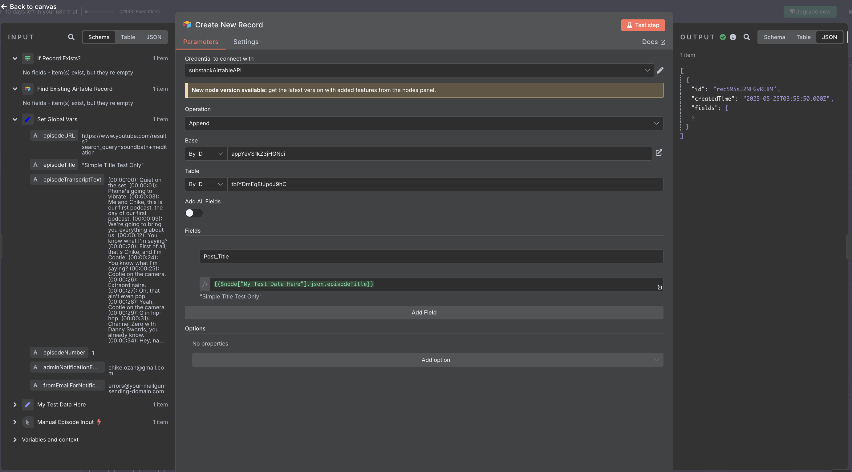

  • using n8n Cloud Version 1.94.0 (Latest Beta) .
  • The Airtable node in m workflow indicates “Airtable node version 1 (Latest version: 2.1)” and you cannot update it via the UI.

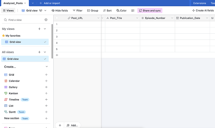

  • The Airtable node successfully creates a new row (returns a record ID and createdTime).

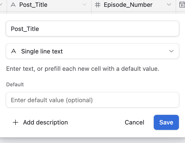

  • However, no fields are populated in Airtable , even when testing with a single, simple “Single line text” field (e.g., Post_Title) where the field name in n8n exactly matches the Airtable column name, and “Add All Fields” is OFF.
  • My Personal Access Token has the correct scopes (data.records:read, data.records:write, schema.bases:read) and base access, and the connection test is successful.
