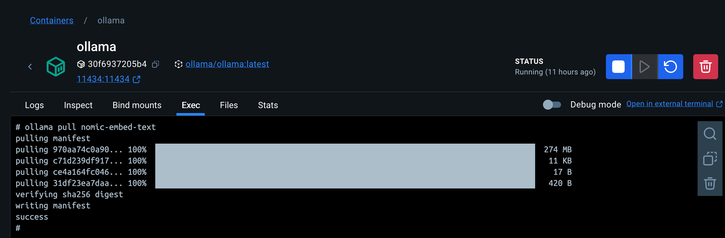

The easiest way to pull the model is from the Docker’s Exec tab in the correspinding container.
Once pulled this way the node will have the model listed.
