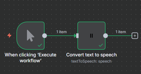

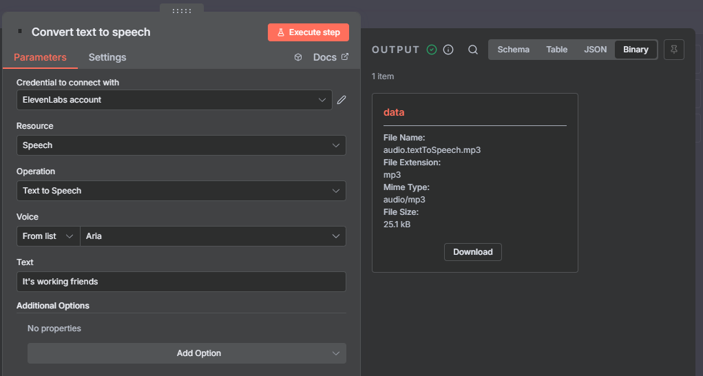

It’s working on my side
For everyone having the issue, please try the following:
  1. Ensure you’re on the latest stable version of n8n
  2. Delete the node giving the error and add a fresh on from the nodes panel
Sometimes a big is fixed or we update a node to match a services API update and putting a fresh node in is required. Existing placed nodes are not updated incase your logic is dependent on old functionally that is changed
