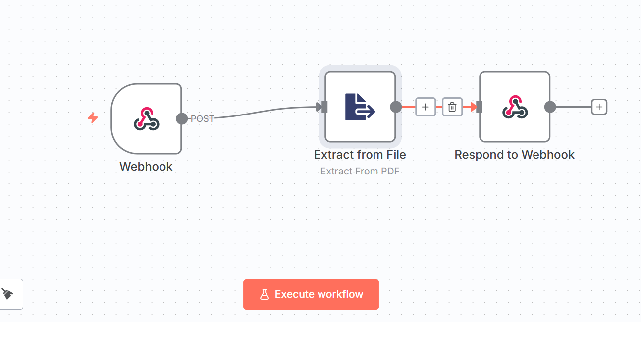

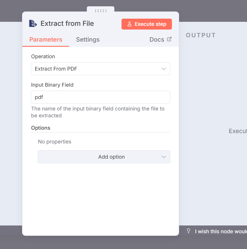

Can you share your workflow???
You should also share a screenshot of your workflow and the PDF (If possible) you are testing with. This will help others understand the setup and suggest more accurate solutions.
I created a sample workflow using only the Extract from PDF node to test why it wasn’t working, but even with this simplified workflow, it still did not work.
