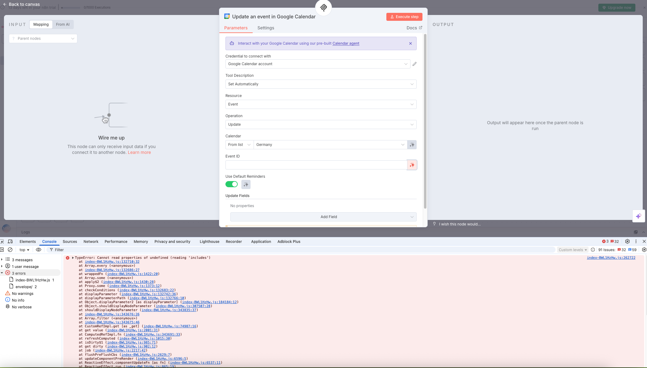

I’m facing an issue when creating an MCP Server Trigger using the Google Calendar tool.
In the UPDATE function, when I try to assign values via AI to the fields, the screen completely freezes, and I have to close and reopen the browser window. However, even after reopening the browser, the problem persists.
It’s important to note that this happens only with the UPDATE function — all other functions (such as CREATE and DELETE) work just fine.

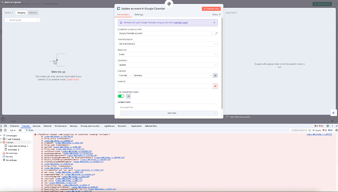

Hey marcossilva, I could replicate the problem with an MCP Server Trigger + Google calendar “Update” tool:
As soon as you hit one of the AI buttons it freezes because a JavaScript error occurs as you can see here:
Indeed the problem has already been reported on n8n’s GitHub page: Google Calendar Tool: UI Freeze When Selecting “Let the Model Define This Parameter” in Update Operation · Issue #20848 · n8n-io/n8n · GitHub
You can click on the “Subscribe” button if you want to get informed on any updates (you need to have a GitHub account for this):
