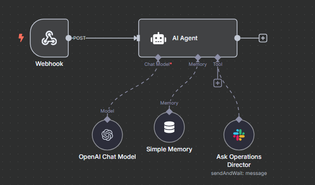

Issue with Slack Send and Wait node when used as a sub workflow to a Tools agent

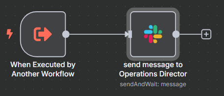

I have a main workflow that has a Slack webhook as a trigger that then flows into a Tools Agent node. This Tools Agent has a “Call n8n Workflow Tool node” that points to a subworkflow which has a Slack “Send and Wait” node. The purpose of this Slack node is to send a question to a team member, wait for them to answer, and once they answer the “Send and Wait” node" resolves. I can even see the output data for this node. However, this response doesn’t get sent back to the AI agent. When you check the output log for the AI Agent, you can see that it was able to invoke the subworkflow properly, but the output only shows the parameters passed on from the AI agent tool and not the response from the last node (send and wait). The note from the “Call n8n Workflow Tool node” states: “This tool will call the workflow you define below, and look in the last node for the response. The workflow needs to start with an Execute Workflow trigger”. It does execute properly, the issue is that the response doesn’t get sent back to the AI Agent.

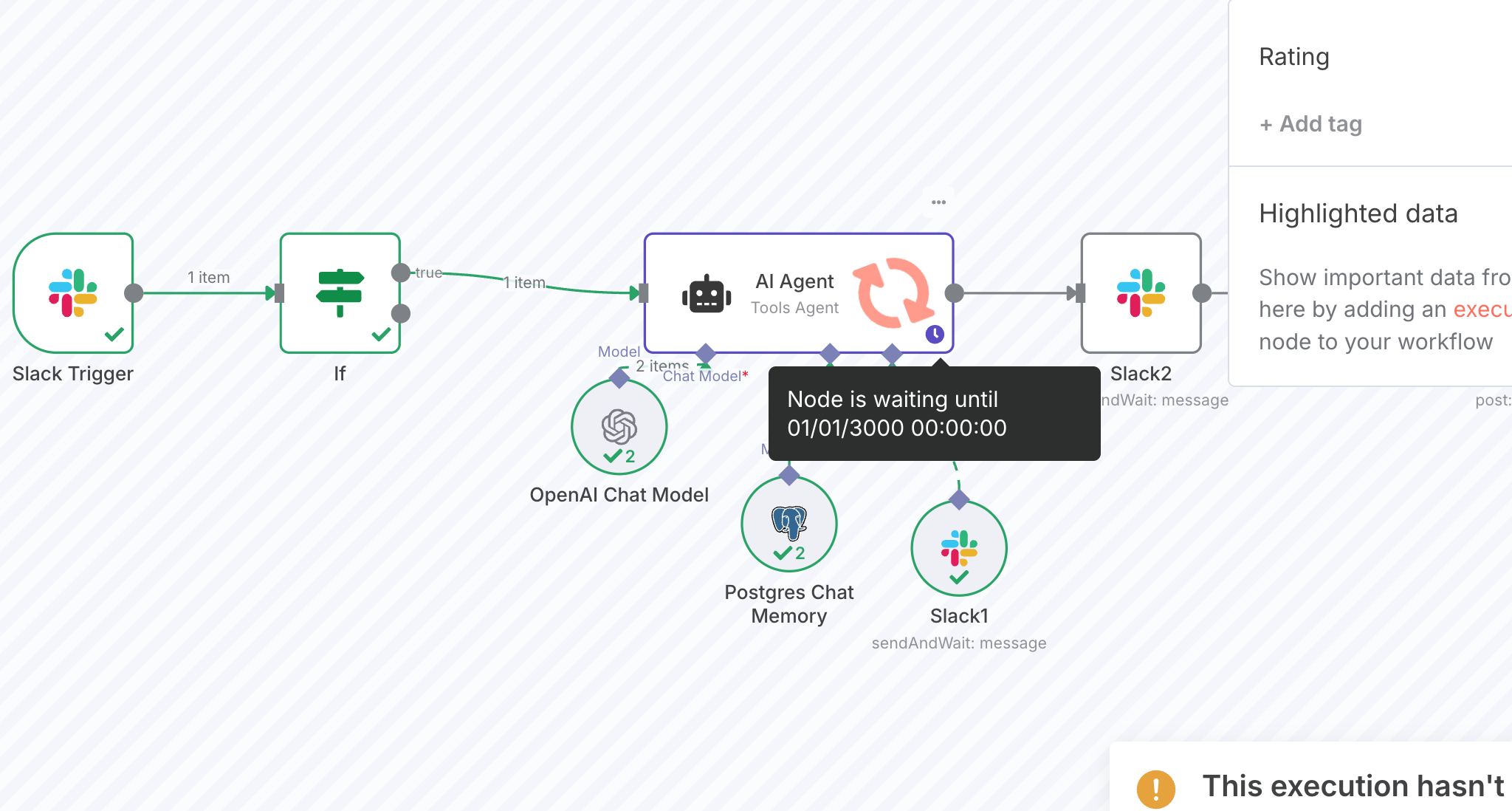

Alternatively, I attached a Slack “Send and Wait” node directly as a subnode to an AI Agent. When the subnode is called, the message gets sent to the user, but when they click on the Respond button to fill out the form, the page says “No action required” and there are no fields to fill out.

I’m experiencing the same issue in version 1.109.0. When a subworkflow contains a ‘send and wait’ node, the ‘Execute Workflow’ node returns the input instead of the subworkflow’s result, even though the subworkflow runs successfully. This same issue occurs when a workflow tool node uses a ‘send and wait’ node; the AI Agent node also returns the input.
Issue persists in 1.112.4. SendAndWait nodes are still broken when used as a tool for an AI agent or if contained in a sub-workflow that is given as a tool to an AI agent.
Hey, I confirm this is a bug and will not be fixed until maybe the next major n8n version. Any nodes that have a wait functionality and are part of a sub-workflow will cause the sub-workflow to not return any data back to the main flow.
