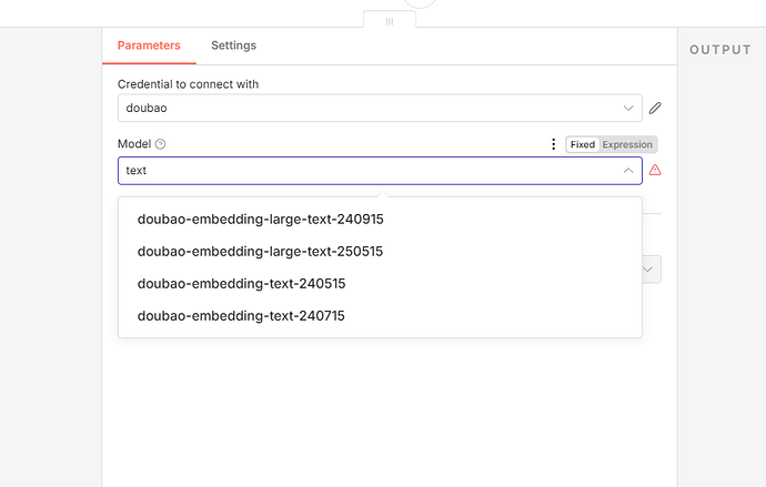

  • SiliconFlow: My previous workflow was working fine, but now the model list is completely empty (no models are displaying).

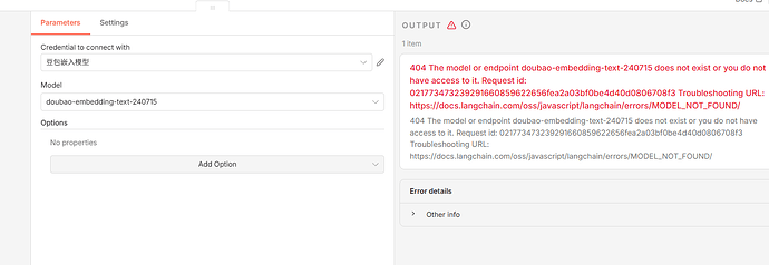

  • Volcengine: The models show up in the list, but I receive an error upon calling them.
  • Note: I have already verified that I have enabled the necessary permissions for the corresponding models.

You need to review your account on langchain to know if you have access to that model.
The HTTP Error indicates the model you’re requesting does not exist or you no longer have access to it. The Model or endpoint doubao-embedding-text-240715 does not exist or you do not have access to it.
Otherwise - if you’ve checked and you’re certain the issue is not langchain. I would recommend remove this node completely and restart your credentials - see if a complete node recreation will resolve any caching problems.

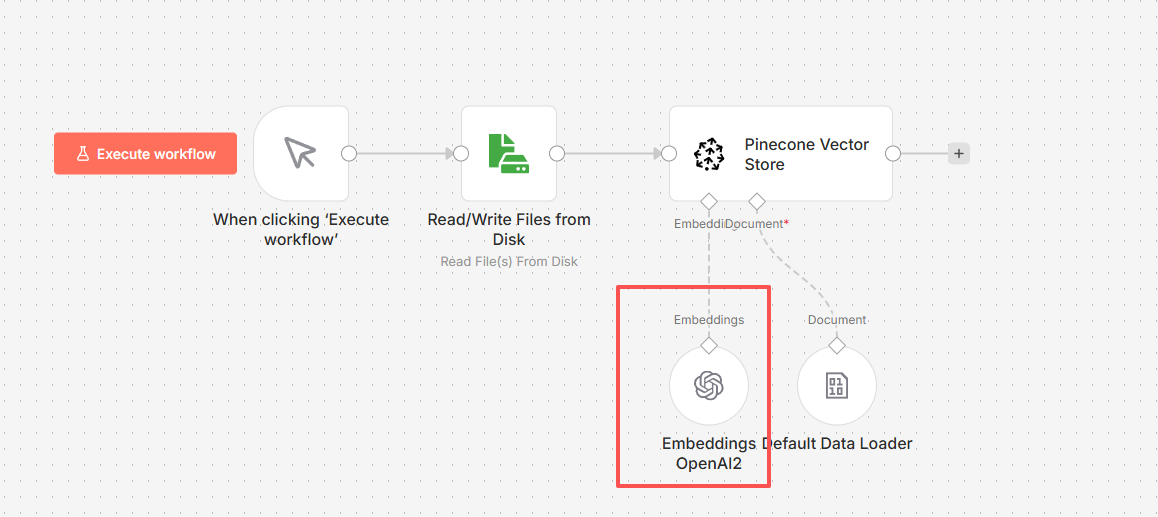

“nodes”: [
“parameters”: {},
“typeVersion”: 1,
“position”: [
1936,
944
“id”: “e9937822-5295-45d7-a79d-eba1eae47c25”,
“name”: “When clicking ‘Execute workflow’”
“parameters”: {
“fileSelector”: “/images/测试-心橙 AI 工作室:以智能之橙,点亮产业创新之心.pdf”,
“options”: {}
“type”: “n8n-nodes-base.readWriteFile”,
“typeVersion”: 1,
“position”: [
2144,
944
“id”: “7255effb-07a6-4fb0-a6c3-970626389fff”,
“name”: “Read/Write Files from Disk”
“parameters”: {
“mode”: “insert”,
“pineconeIndex”: {
“__rl”: true,
“value”: “n8n-1208”,
“mode”: “list”,
“cachedResultName”: “n8n-1208”
“options”: {
“pineconeNamespace”: “ceshi”
“type”: “@n8n/n8n-nodes-langchain.vectorStorePinecone”,
“typeVersion”: 1.3,
“position”: [
2352,
944
“id”: “3987c8ef-3892-4583-afa3-81cb22346514”,
“name”: “Pinecone Vector Store”,
“credentials”: {
“pineconeApi”: {
“id”: “KE0J7XDddzVy8q2b”,
“name”: “PineconeApi account”
“parameters”: {
“dataType”: “binary”,
“options”: {}
“type”: “@n8n/n8n-nodes-langchain.documentDefaultDataLoader”,
“typeVersion”: 1.1,
“position”: [
2480,
1184
“id”: “b3d4ccfe-a208-4f71-b1d5-76817d2fb058”,
“name”: “Default Data Loader”
“parameters”: {
“model”: “doubao-embedding-text-240715”,
“options”: {}
“type”: “@n8n/n8n-nodes-langchain.embeddingsOpenAi”,
“typeVersion”: 1.2,
“position”: [
2352,
1184
“id”: “370ac084-23af-4a33-ab3d-280bbaf0f985”,
“name”: “Embeddings OpenAI2”,
“credentials”: {
“openAiApi”: {
“id”: “vW7oXv8cUvtDfYEw”,
“name”: “302”
“connections”: {
“When clicking ‘Execute workflow’”: {
“main”: [
“node”: “Read/Write Files from Disk”,
“type”: “main”,
“index”: 0
“Read/Write Files from Disk”: {
“main”: [
“node”: “Pinecone Vector Store”,
“type”: “main”,
“index”: 0
“Default Data Loader”: {
“ai_document”: [
“type”: “ai_document”,
“index”: 0
“Embeddings OpenAI2”: {
“ai_embedding”: [
“type”: “ai_embedding”,
“index”: 0
“pinData”: {},
“meta”: {
“instanceId”: “72b9b14682050c5676171cb5e88adfd1af09dd60cb9447df66d18ba4072efb4e”

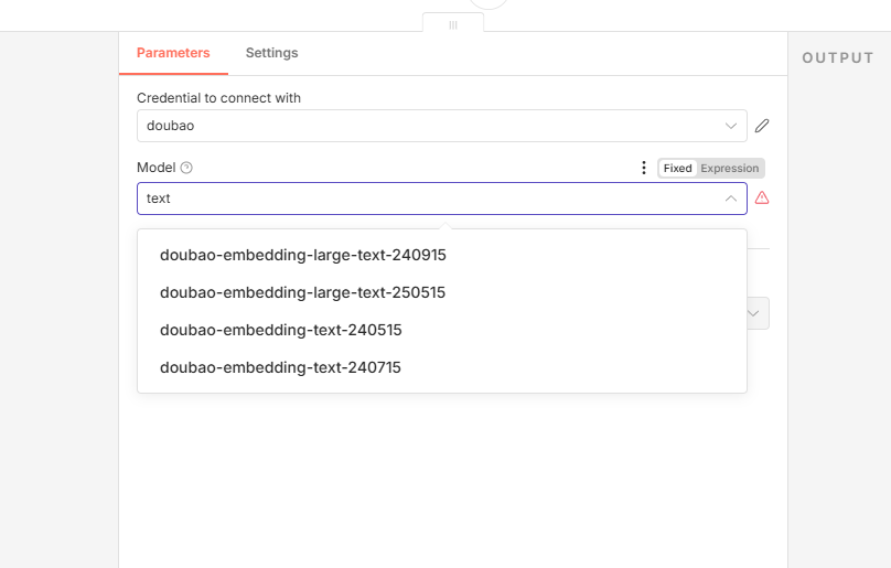

I don’t have text-embedding-3-large in my dropdown menu.
@xincheng set your BASE URL in the node credentials to this https://api.openai.com and then save and you will be able to see text-embeddings models and then choose the large one. And that would start working.

@xincheng According to the error which clearly says that MODEL endpoint <model_name> does not exist, which means you have to use official API key and base URL which i have suggested to be able access the standard models which are text-embedding, OR see which models actually exist in that BASE URL model provider alternative you are using and then use that although as it seems like they only support 3-4 models and neither those are working, so possible and best approach would be to use official OpenAI base url with their key.
