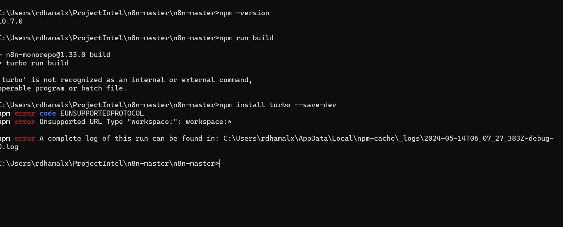

I suppose you need that one
I flow the same instructions facing issue with provided images
could you help me out off this
Well, the docs quite old.
To use workspace, you need to install pnpm
@bartv fyi, there are old instructions out there
