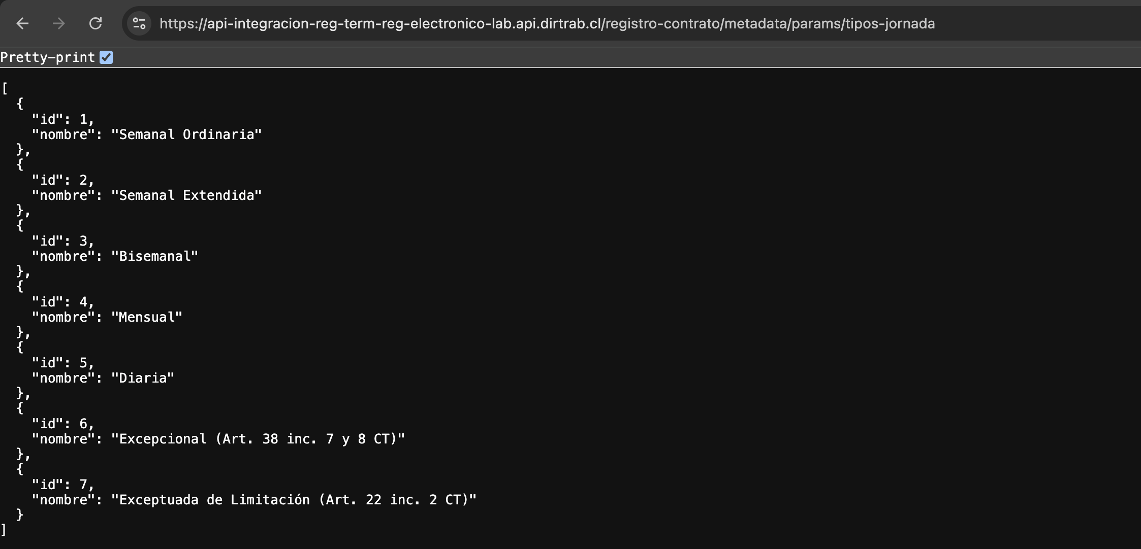

yes!

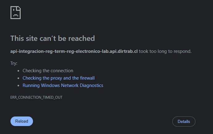

The link isn’t working, so it’s expected that it won’t work in n8n either.
well, that is wierd, I do see the response
I’m definitely not an network expert, could it be related to that? I guess that would explain that you couldn’t get the response. Maybe cookies (?)

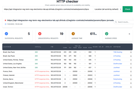

Hi @chalodk
It looks like the link is restricting access from certain locations:

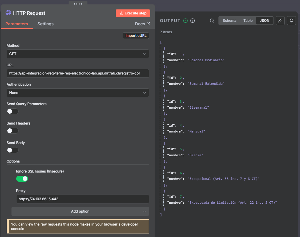

Using a proxy should allow it to work, something like this:
However, the best solution would be to host your n8n server in a location that the website allows, especially if this is critical, Proxies generally aren’t safe use..
Got it! thank you very much @mohamed3nan
