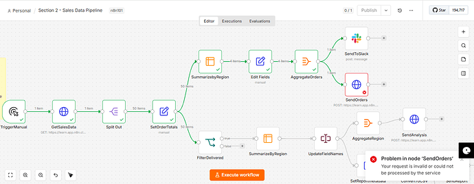

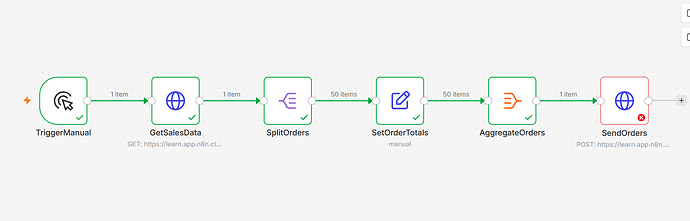

Issues with the Sendorders in n8n Foundation course exercise
While sending Order to the n8n site, I get the below errors. I checked for spaces, calculations etc, but can’t find the error source. All my nodes are executing perfectly when done individually
What is the error message (if any)? Your request is invalid or could not be processed by the service. Your order totals are incorrect. Please ensure you are calculating the totals correctly.

Hi Swapnil
Thankyou for such a prompt response. Let me explain what I did before I posted this issue
  1. I checked all nodes if the data type for the order total is correct. it is set as numbers
  2. In the Send Node,
    1. In body, the Body content type is JSON
    2. Specify Fields :
    3.     Value:  {{ $json.orders }}
All the nodes execute perfectly well without any errors.
I tried the Webhook too and there are no errors there.
The below is the webook result
{“orders”:[{“sum_order_total”:5348,“count_order_total”:16,“average_order_total”:334.25,“region”:“north”},{“sum_order_total”:2507,“count_order_total”:10,“average_order_total”:250.7,“region”:“west”},{“sum_order_total”:2353,“count_order_total”:14,“average_order_total”:168.07,“region”:“south”},{“sum_order_total”:2263,“count_order_total”:10,“average_order_total”:226.3,“region”:“east”}]}

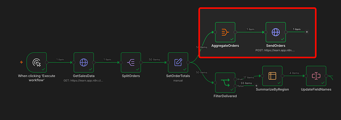

Hi @venu_nair ,
You might need to compare your workflow with the instructions again, as I see your above branch has a bit more nodes than the previous time I did.

I am getting similar error for the same workflow which is share at the URL Course | n8n Platform
Following is my workflow and the error message.
Any help spotting the issue is much appreciated! :slight_smile:
Worklfow
Workflow Code
Section 2 - Sales Data Pipeline.json (5.6 KB)
Error Obtained in the last Node - SendOrders
“errorMessage”: “Your request is invalid or could not be processed by the service”,
“errorDescription”: “Your order totals are incorrect. Please ensure you are calculating the totals correctly.”,
