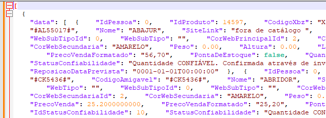

I am getting an output JSON from an HTTP Request, but I just cant seem to find a way of parsing it into a JSON so I can save it to a database. I have read dozens of articles, but havent found anyone with a similar problem. Tried all snippets shared on posts (regardin JSON parsing issues), tried split, tried edit fields,

Nothing seems to work. The output file looks OK when I open in an JSON editor, but n8n simply won’t parse it… I am not sure what I am missing…

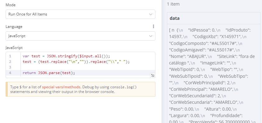

After some trial and error testing, I noticed what needs to happen for it to work properly. I need to get rid of: \n, \ (from ") and the first and last "
I tried with javascript, but it looks like it is not finding matching strings and simply returns the input.
If I manually edit the input, removing \n and \
Then, voilà!
Has anyone ever seen anything like it?
Any ideas on how to accomplish it?

thank you very much, I really appreciate you taking yout time to help… but this code didn’t quite work for me (tried .first() as well)
const myData = [{"data": $input.all()}]
return JSON.parse(myData[0].data);
"[object Object]" is not valid JSON [line 3]"
SyntaxError

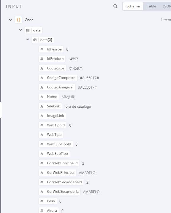

However, once I mapped the http request output, I managed to solve with this JS:
  // load input as string
  let str = JSON.stringify($input.all());
  // clean input
  str = str.replaceAll('\\n','');
  str = str.replaceAll('\\r','');
  str = str.replaceAll('\\','');
  str = str.replaceAll('  ',' ');
  // http request added quotes to data array ( { "data": "[{},{}]" } )
  // so the code below removes it. Since it is always a fixed
  // position, I indexed all quotes i string and removed these two
  let quoteIndexes = [];
  for (let i = 0; i < str.length; i++) {
    if (str[i] === '"') {
      quoteIndexes.push(i);
  if (quoteIndexes.length < 5) {
    console.log("Not enough quotes to remove");
    return str;
  let fifthIndex = quoteIndexes[4];
  let fifthFromLastIndex = quoteIndexes[quoteIndexes.length - 5];
  //remove first quote
  let result = str.slice(0, fifthIndex) + str.slice(fifthIndex + 1);
  if (fifthFromLastIndex > fifthIndex) {
    fifthFromLastIndex -= 1;
  // remove second quote
  result = result.slice(0, fifthFromLastIndex) + result.slice(fifthFromLastIndex + 1);
//console.log(result);
return JSON.parse(result);
But I still believe this is simply a jerry-rig and there’s probably a much easier way for accomplishing it in n8n…
