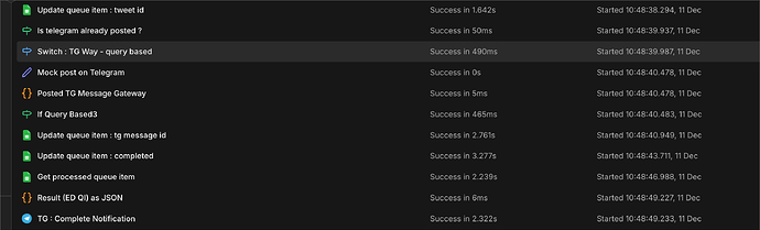

Last few nodes of a big workflow taking unusually huge time in viewing, editing & executing
I have a big workflow in which last few nodes, all taking unusually huge time in opening/editing in builder as well as in execution. See screenshot of logs below. Time taken by them is also same in seconds in every execution (which is very high). To fast edit those nodes in builder what i painfully doing is 1st disconnect them by removing inbound connections to previous nodes, than they become fast to open & edit, than edit them & than reconnecting them with inbound connections to previous nodes.
Input & output all are fine for each nodes as expected, workflow input & output all are fine except that time taken by last few nodes. Last node is sending notification to my personal telegram, output of it is api response from telegram which is fine.
  • **n8n version: Latest (**1.123.4)
  • Operating system: MAC

Ok yes in that case it should not take up to 30 seconds to try and return an item from the sheet. Is it possible to share your workflow with some sample data pinned in a code block. I’d like to see if I can run it on my instance so we can determine if it’s the nodes or maybe something weird with your setup. It looks like you’re just running a local npm instance?
Ok so i went on with diagnosing whats causing this issue by duplicating the workflow & experimenting changes.
Problem is this Error Gateway node. It is connected with many node’s error output. What i am doing is - if for some reason any node causes error due to which google sheets row item cannot be processed completely, through this error gateway thing - i am increasing failed counter column value by 1 + for rows with failed counter 2 or less its still get processed in next execution + but if failed counter for such row is 3 or more mark it failed so it does not get processed in next execution + notify on telegram so i am aware.
For me the workflow is what i like to be but i think its not going well with n8n coding implementation, with this many nodes connecting to error gateway, those subsequent nodes start performing very poor (both in builder opening/editing time as well as execution time whether in main or worker / dev or prod). Even though error gateway & subsequent error handling nodes are called rarely when some node caused error, it downgraded the performance for me.

So as a 1 solution/alternative - i duplicated those last nodes specifically for error cases, to keep error & normal workflow separate.
The results are promising for non-error cases, for error cases it would still lead to those huge time taking nodes at the end.
This also proved thats what was the issue which i shared in previous post. But i believe this needs to be addresses by n8n developers, when those error nodes were anyways not executing why it was downgrading the execution performance ?
Yes i know developers would suggest breaking down bigger workflow into sub-workflows (avoid monolithic workflow), but i am still curious why it causing issue when those error flow nodes are not called anyway ?
