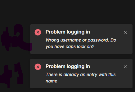

I started on the community edition on-premise and migrated to the business edition because I need the extra features. I had about 6 users that I used the invite feature. Once we upgraded to business, i successfully setup the LDAP connection. We are using the same email that we used before the LDAP connection. Each user logged on successfully except for one. It told him that his password was incorrect. If he used the incorrect password, it told him that there was already a user that existed. If he used the correct password, it said the password was incorrect.

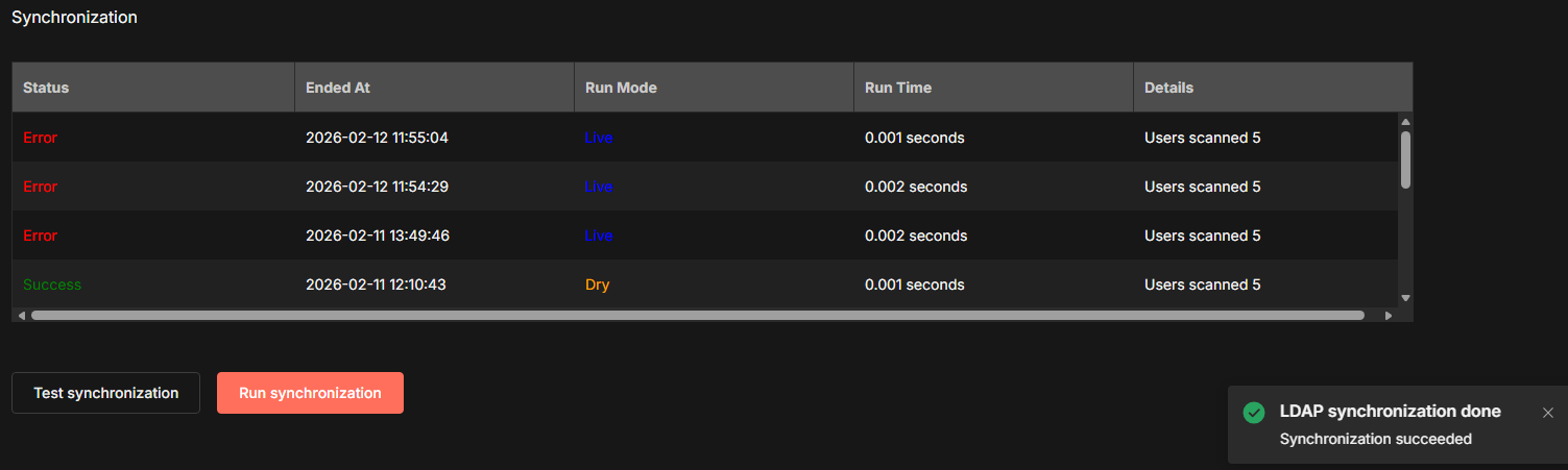

Also, if I run a test synchronization, i get a success, but if I run it, I get an error, but the toast notification says success.

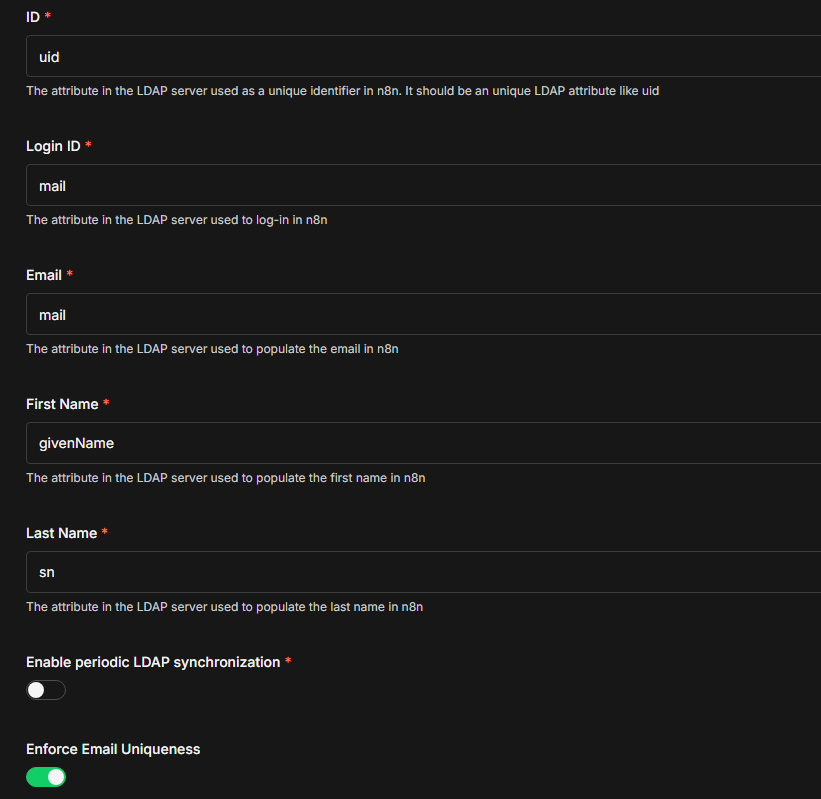

Just wanted to update you and to thank you.
The issue was the using the “uid” in the “ID” attribute mapping.
I changed it to “ sAMAccountName”. I also deleted both users for good measure and had both users logon again and it was fixed.
