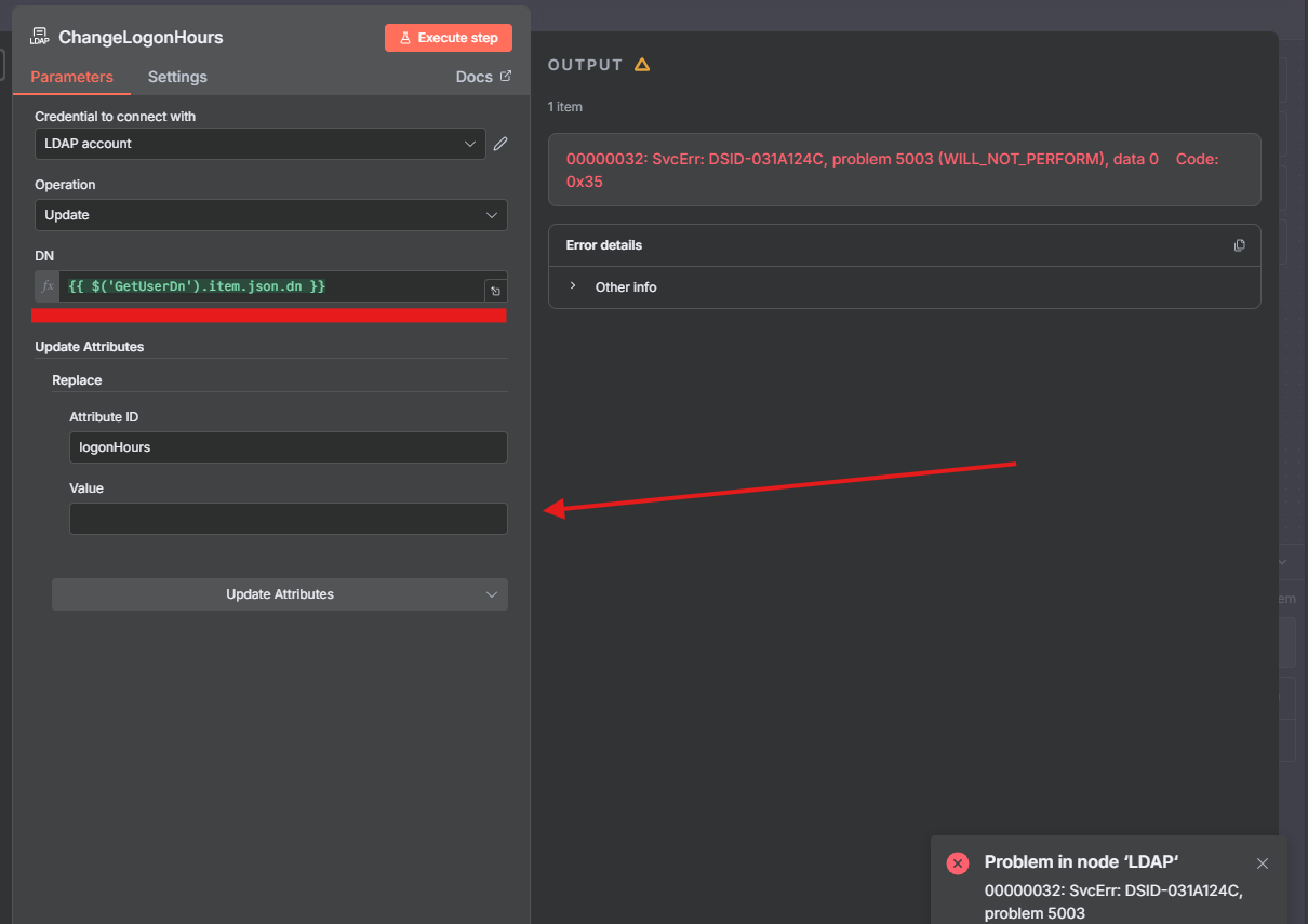

Hey Guys, I´ve been using n8n for some time and i´m stuck in a problem.
I Need to use the LDAP Node to change a user logonHours attribute but I didn´t find out which type of informations does it need in the “Value” input field.
Currently i´m using n8n´s version 1.119.1 self hosted in a kubernetes environment

Hi, did you find anything yet, the solution from Gede_Suparsa didnt work for me and currently stuck on the same Problem
