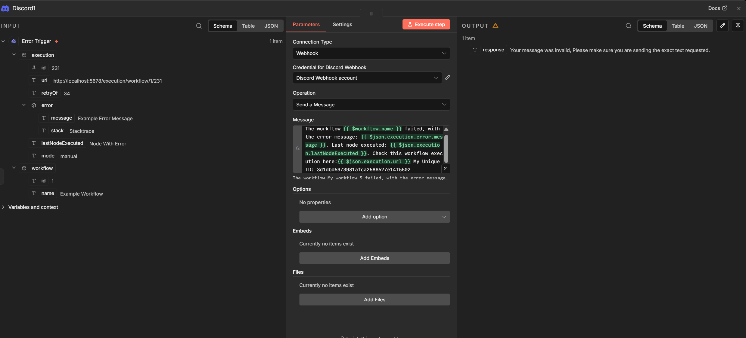

what page of the level 2 documents are they referring to? i have sent multiple lines to discord and they show up under level 2
it wont send and im not sure why not.
still wont send to discord
still wont work.
I did and it’s still not working. I have tried on local hosting and on the web hosting and got the same results.

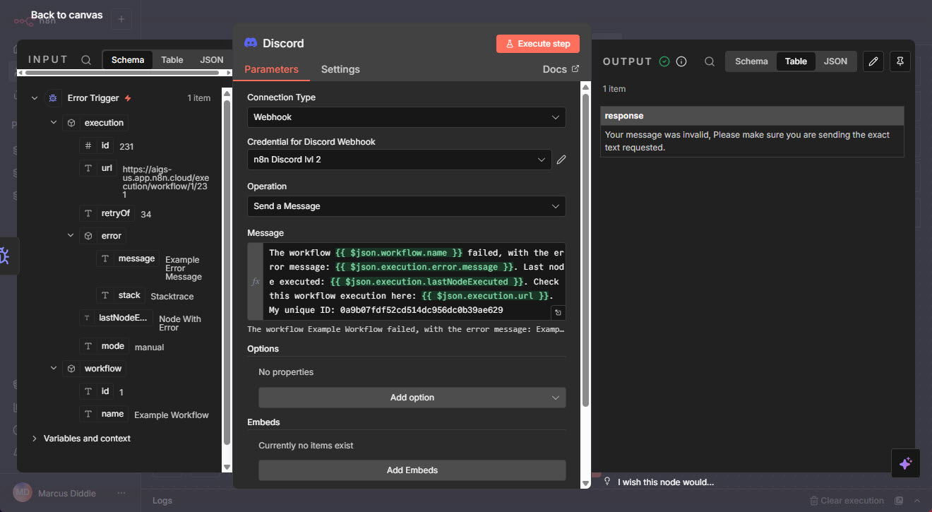

I got the same email response and am having this same issue. I can send the message to my own Discord server without issue, but when trying to send it to the n8n course-level-2 thread, I get the error noted above (your message was invalid, please make sure you are sending the exact text requested). It seems the n8n Discord channel has some kind of predefined filter or regex that isn’t matching what is being sent from the workflow and rejecting it.

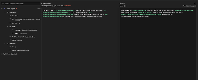

The only issue I got was with the error message returning as invalid. Though I matched the format and each character multiple times.
