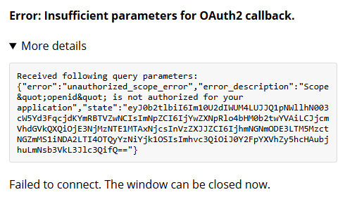

What is the error message?
Received following query parameters: {“error”:“unauthorized_scope_error”,“error_description”:“Scope “openid” is not authorized for your application”,“state”:“eyJ0b2tlbiI6IkNzMzk3TzUyLXBQZmxCZzRnaEdJRmRVV3JfNmJDV1ZCZVFCdyIsImNpZCI6InRCRHlIaUdmVjlteHhtcUgiLCJjcmVhdGVkQXQiOjE3NjMzNDkxNTczMjMsInVzZXJJZCI6IjhmNGNmODE3LTM5MzctNGZmMS1iNDA2LTI4OTQyYzNiYjk1OSIsImhvc3QiOiJ0Y2FpYXVhZy5hcHAubjhuLmNsb3VkL3Jlc3QifQ==”}

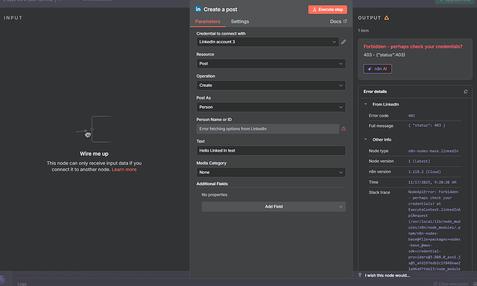

Sharing step by step screenshot of trying to enable the linked in credentials.

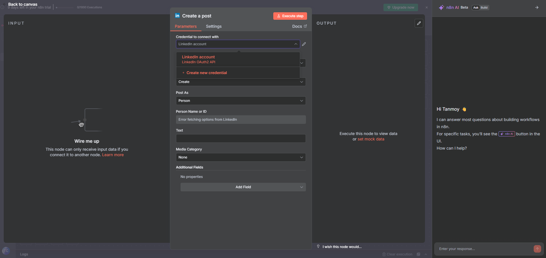

Step 1 : Create a new linked in node and clicked on create new credentials -

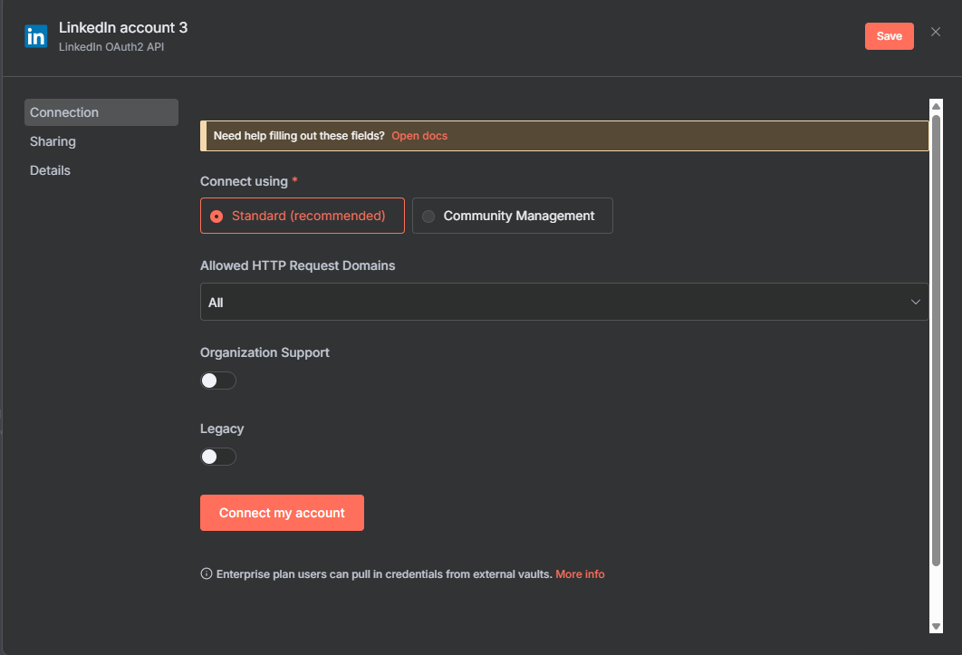

Step 2 : Unchecked Organisational Support and Legacy , clicked on connect an account
Error -

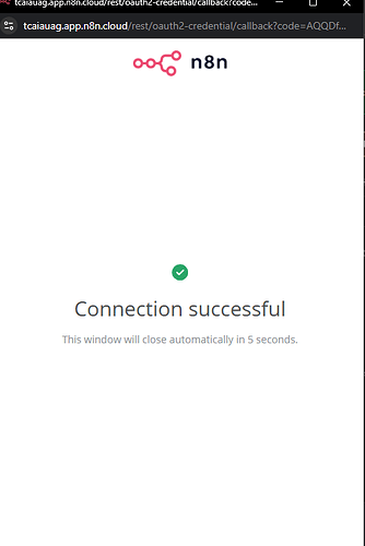

Alternate Step 2 : I have tried keeping Legacy On and the connect my account , then the pop up asks me to login and Allow N8n permissions , on allowing it does show Connection Successfull -

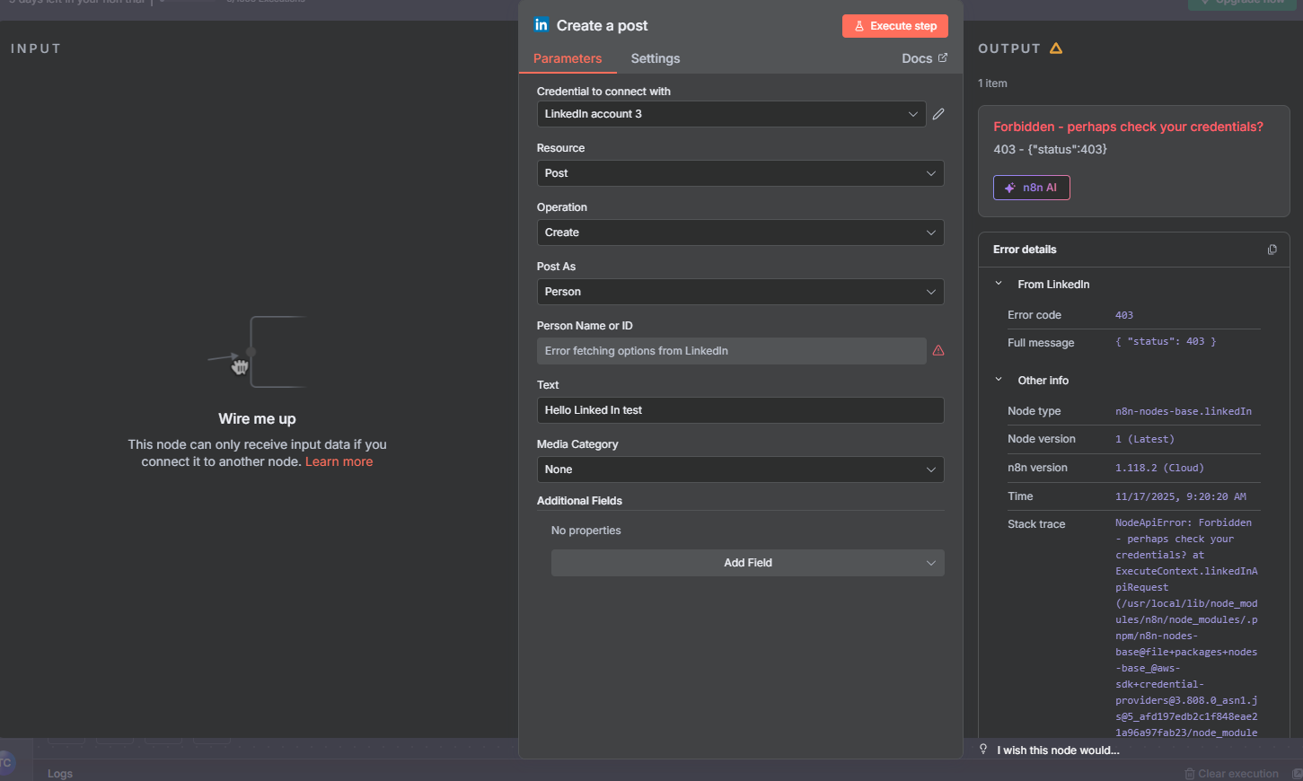

Step 3: Now , the person field should have my name in it but it doesn’t show , so in expression I mentioned the Name and when I put a text and click on execute , I get a 403 error , which n8n suggest is due to credential problem.

IDK what changed after I raised it in community support and created a ticket as a bug , it started working. However , the last post on linked in node fails while execution with a 403 error but the post gets posted on linkedin.
