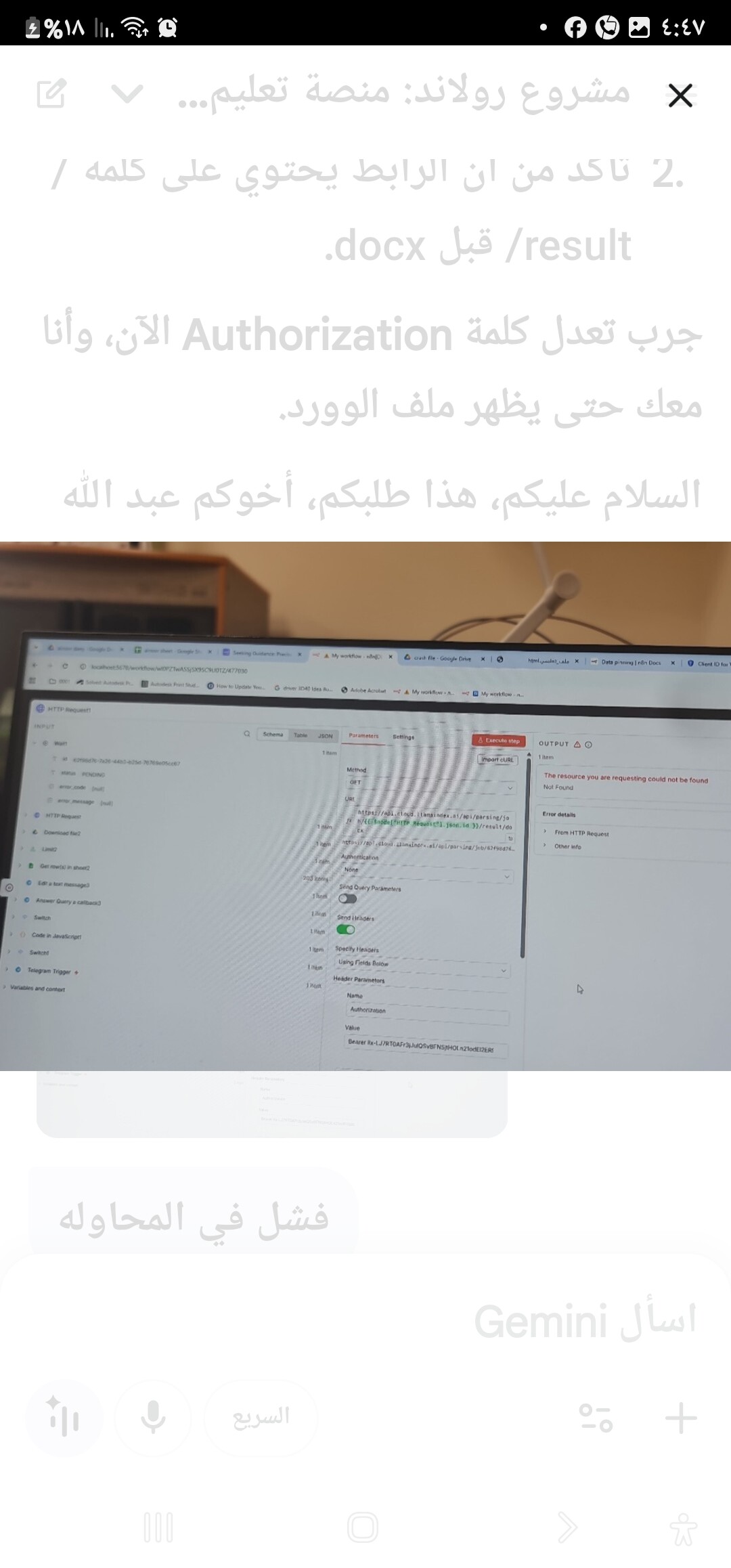

I am working on an automated system (Roland Project) to convert PDF files to DOCX using the LlamaParse API. My workflow follows these steps:
  1. HTTP Request (POST): Successfully uploads the PDF and receives a Job ID (Status: PENDING).
  2. Wait Node: I have implemented a 60-second delay to ensure the file is processed.
  3. HTTP Request (GET): Attempts to retrieve the converted file using the following URL:
    https://api.cloud.llamaindex.ai/api/parsing/job/{{ $node[“HTTP Request”].json.id }}/result/docx
    The Issue:
    Even after the 60-second wait, the second node returns a 404 Error: “The resource you are requesting could not be found.”
    Technical Setup:
Hi @abd2001
The 404 error occurs because LlamaParse does not support DOCX as an output format.
While LlamaParse can read DOCX files as input, its purpose is to convert documents into LLM-friendly formats like Markdown, JSON, or Text. It is not a direct “PDF-to-Word” conversion tool. The endpoint .../result/docx simply does not exist.

Hi @abd2001!
You are getting 404 because that source does not exist, the endpoint you are trying to reach which is /result/docx does not exist and is not a supported format, the supported formats are:
/result/markdown
/result/text
/result/json
/result/pdf
For your use case you have to first convert that DOCX file into markdown or text and then use endpoints like /result/markdown , /result/text and this would work, hope this helps.
Hi @abd2001 ,
Looking at your screenshot, I can see you’re working on a n8n workflow for the Roland Project to convert PDFs to DOCX using LlamaParse API. The 404 error you’re getting is frustrating, but it’s likely one of a few common issues.
The main problem is probably that 60 seconds isn’t enough time for the file to be fully processed, or you might need to check the job status before trying to download the result.
Here’s what I’d suggest:
First, instead of just waiting 60 seconds and hoping the job is done, you should check if the job actually completed. Add a step that calls: https://api.cloud.llamaindex.ai/api/parsing/job/{{ $node["HTTP Request"].json.id }}
This will tell you if the status is “SUCCESS”, “PENDING”, or “PROCESSING”. Only try to download the result when it’s actually successful.
Second, double-check your result endpoint. You might need to try it without the /docx part: https://api.cloud.llamaindex.ai/api/parsing/job/{{ $node["HTTP Request"].json.id }}/result
And then specify the format using a query parameter like ?result_type=docx or through headers.
As a quick test, you could also try increasing your wait time to 2-3 minutes just to see if it’s purely a timing issue.
