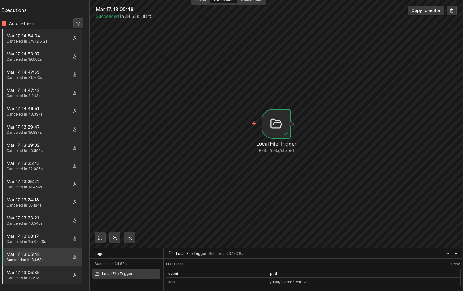

Action 1: Add the node with the following settings: Trigger on: “Changes Involving a Specific Folder” / Folder to Watch: /data/shared / Watch for: File Added / Options: Use Poling.
First execution: Node execution > Creation of a Test.txt file in /data/shared > The file appeared in Output = Great, it works :wink:
I wanted to try again with another .pdf file:
Delete the Test.txt file > Relaunch the node > Drag and drop the .pdf file into “/data/shared” > It searches, searches, searches, and searches some more without finding anything. ; (Oh no.
I thought maybe it was the PDF (it was only one page) > I repeated the process by creating a new Test.txt file > It doesn’t work anymore either…

Memory of the perfect first execution
