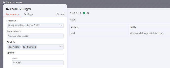

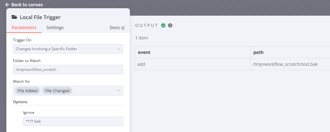

Local File Trigger not ignore file paterns
Just checked on 1.72.1 and 1.78.0, and it appears that the “ignore” option is indeed ignored (i.e. you are correct… it doesn’t work as advertised).

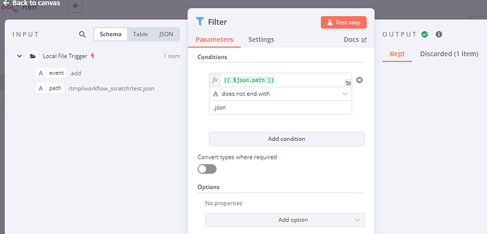

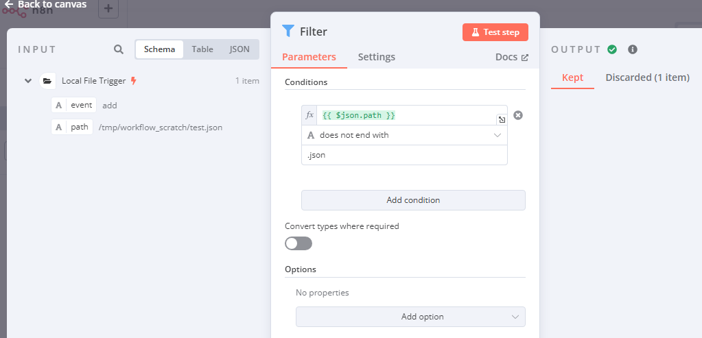

So, until this is fixed, you can avoid further processing files you want to ignore by following the trigger node with a Filter node, and putting the rules there.
If this solves your issue, please mark this as the solution.
Screenshot of it not working right.
