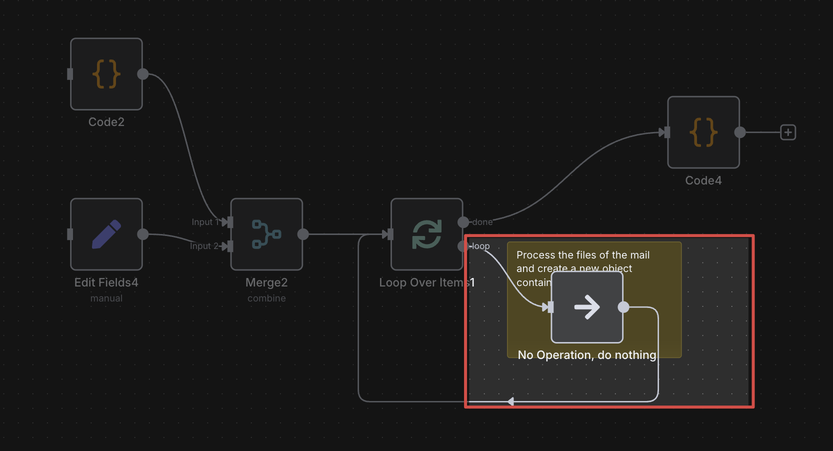

Loop done run multiple times
I have a list of object comming from a combine going through a loop so far so good, but the issue is the done branch is run multiple time
The merge data is like so (it contains binary too)

the ‘Loop’ branch from the ‘Loop Over Items’ has ‘10 items’
but the ‘Done’ has ‘126 items’
No error
i cannot share the output, but the ‘Done’ should (i think) run once containing a list of object, but it’s the case for the first run of the ‘Done’ branch, after that it run multiple times.
The first the run of the ‘Done’ branch is correct, it’s the data that i want.

Can you add the sample data to your flow? The workflow is only running 1 item.
It’s most likely there are something return more than 1 items in the highlight area
Give you an example
This workflow input 5 items and get 25 items after loop.
Because it split again while in loop.
Okay i think you are right i will dig out, i have to mess things out in this (it’s a mess lol)

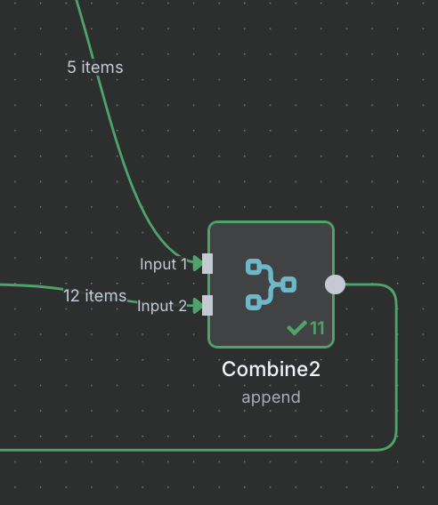

Thanks for your answers. I’ve looked into it and I think my issue is in my loop that processes the files. I have 10 items that are going into loop process, at the end of this branch, I have a Merge block in ‘append’ mode. The problem is that it gives me 17 outputs (5 pdf and 12 images), and my branch ‘done’ in the looping is called 2 times for a total of 31 items. So the problem is indeed in this loop but the issue is, i don’t really know how to fix this, in code it would have been easier for me because i’m used to it, but n8n it’s hard because it’s like a new language. Anyway i have posted the pictures.

Yeah the problem might related to combine.
Since I can not see the full picture about how it combined.
Let’s discussed about what is your expected output when merge
17 outputs (5 pdf and 12 images) → is this good for you?
or other output format should be more correct.
