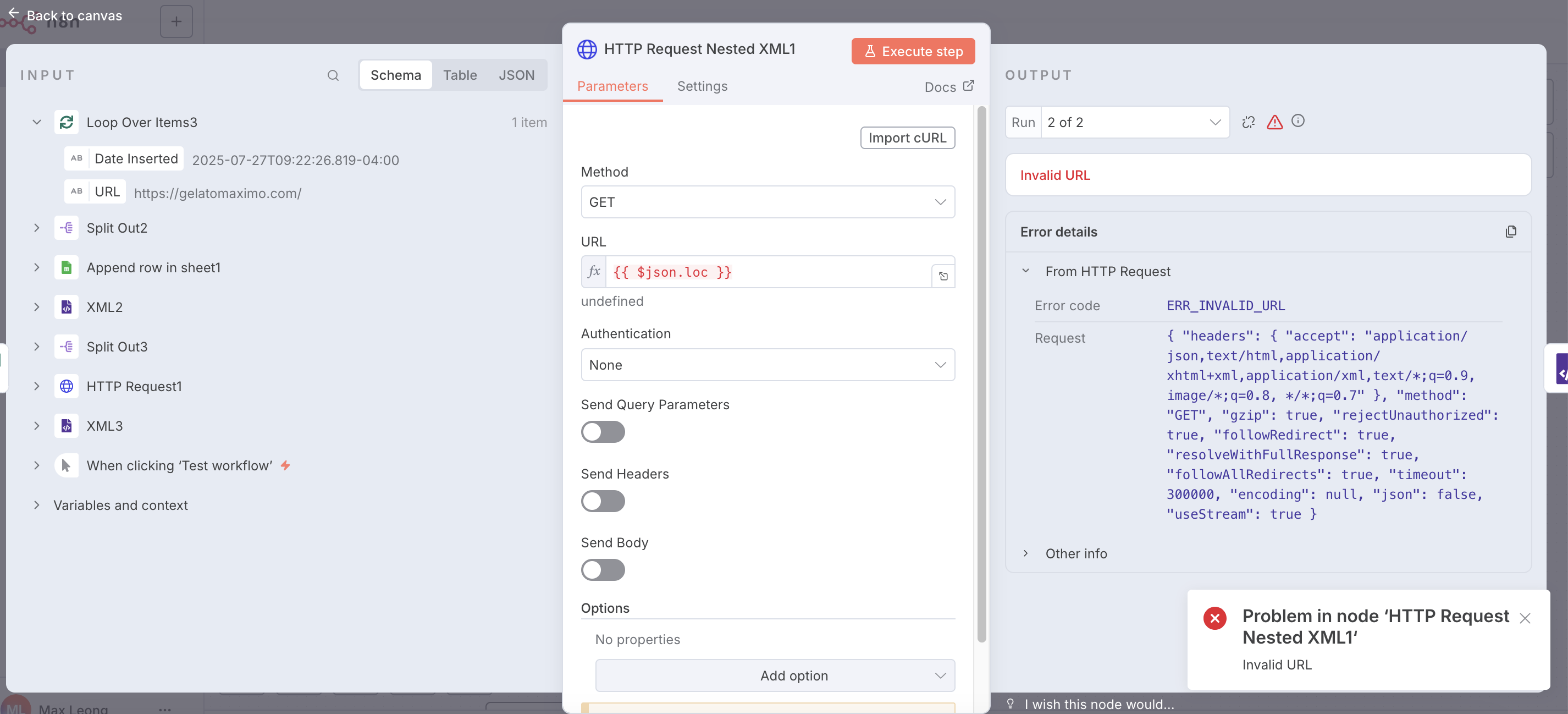

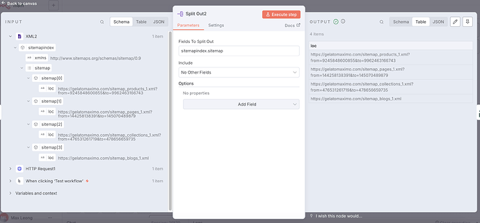

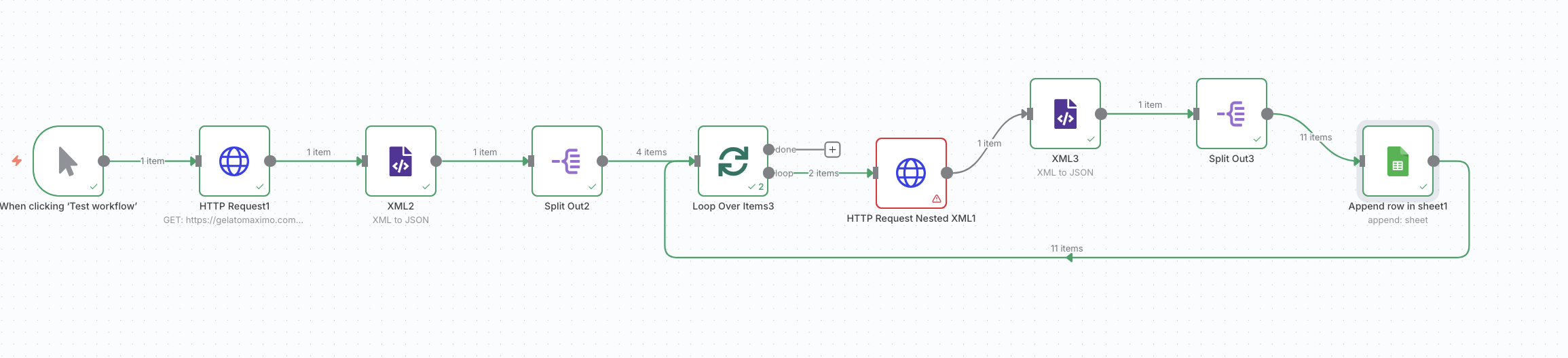

Hi everyone, I trying to scrape a website using the sitemap.xml file. As has nested XML files, I’m trying to “read” out all the URLs and append to a google file.
  1. At the end of the 1st looping, the Google Sheet node’s output is looped as input for the 2nd loop.
  2. The 2nd XML filename should be the input for the2nd loop.
Where did I went wrong? :rofl::rofl:
Thank you in advance for your inputs/solution.

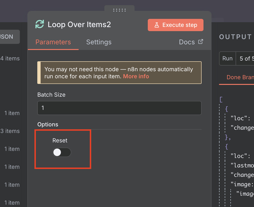

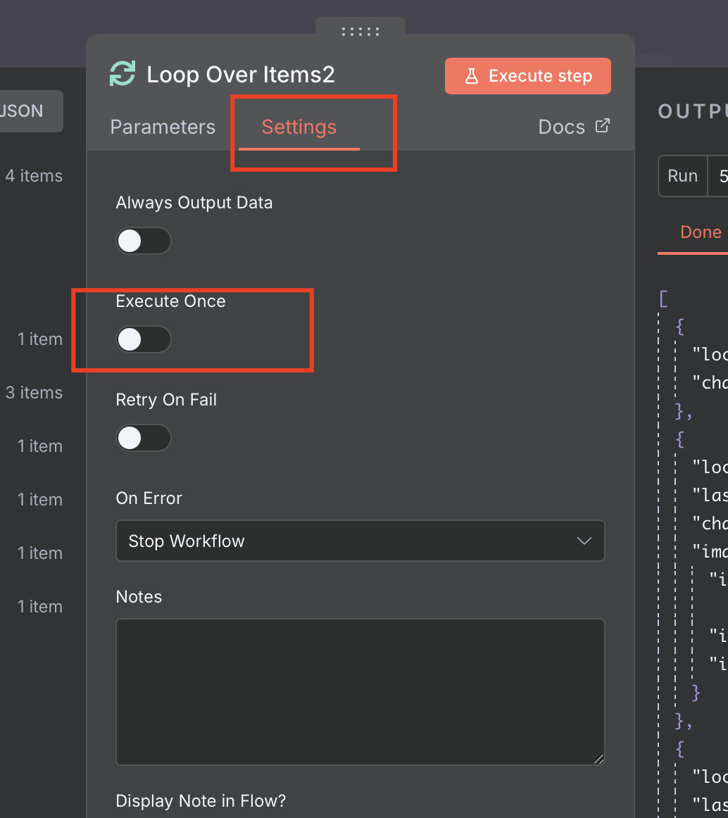

2 problems:
  1. Do NOT set the reset option on the Loop node
  2. Under the Loop node settings, it was set to only run once?
Fixed workflow:
Thank you very much! Solved!
