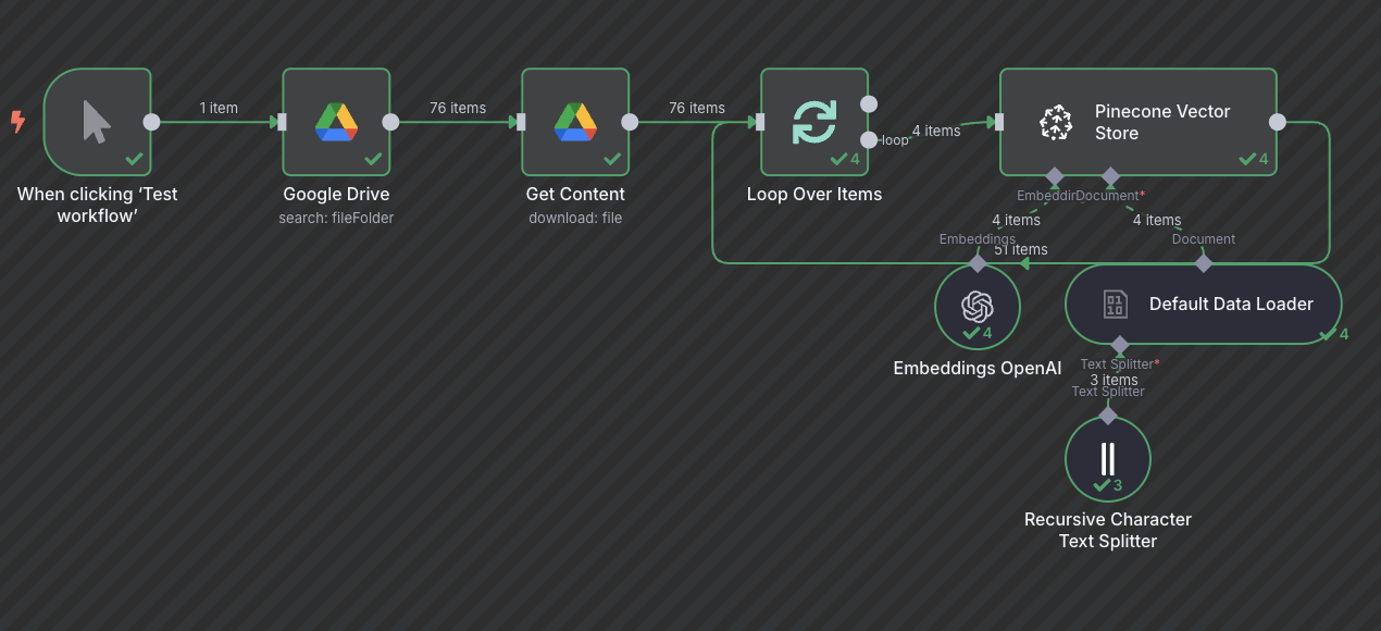

Hey! Thanks for the reply! Sure here it is
So in this run I grabbed 76 items from Drive but it only looped through 4 and added 10 vectors to pinecone

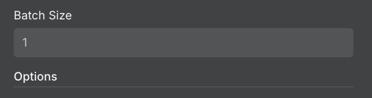

hi, just to confirm, your loop over items batch size is 1?
Yep!

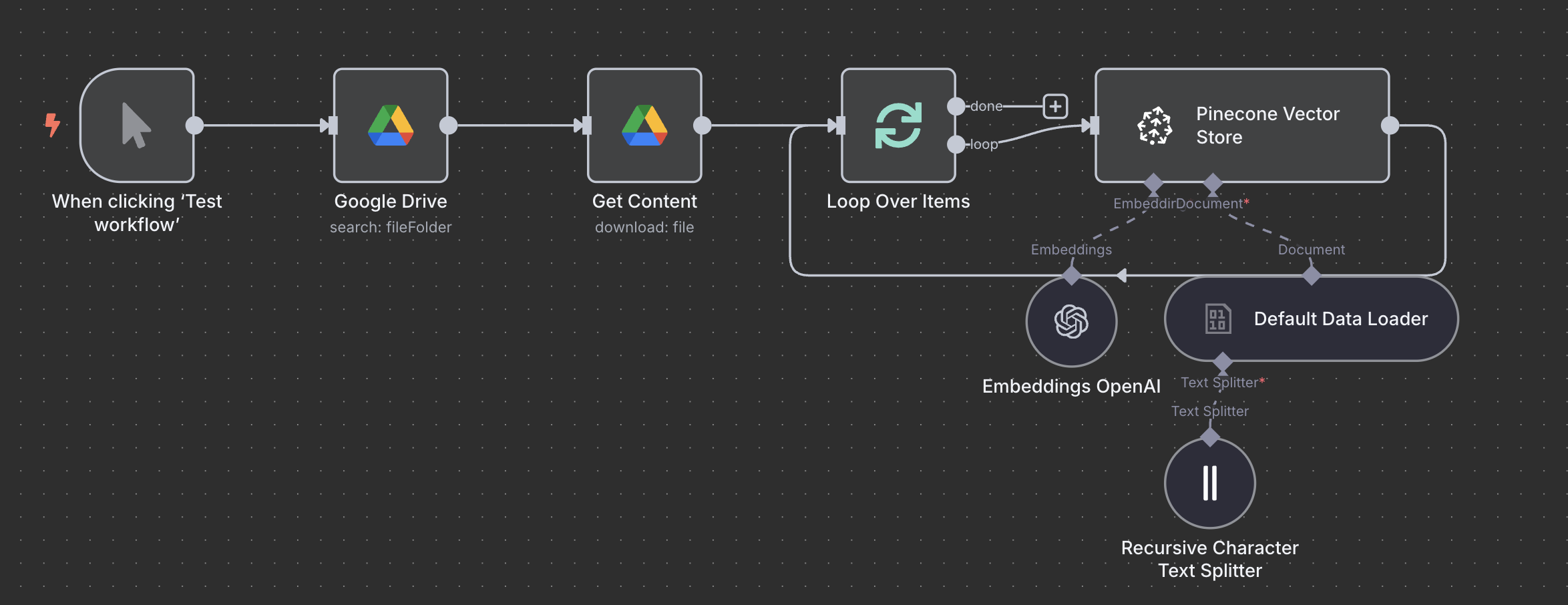

Here is the automation…
Yeah for sure, however Im getting 4 items in the default data loader and I want 76 items in it. It would make sense if I got 76+ items looped but in this case its way less
Im seriously lost as to why this is not working does anyone have any clue?

try adding a wait node inside the loop, might be some problem with the rate limit
add it after the pinecone vector node and set it to some few seconds
