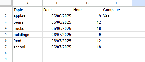

To answer your question… I like to use a date field in the google sheet and test if today is equal to the date in the google sheets field. You can also use hours in a filter. Give me a min, and i’ll give you a sample workflow.

Here’s a workflow that will bring in only one row at a time, and update the sheet when the blog has been sent. Run it once an hour and it should work for you.
The google sheet for this example looks like this.

If you dont want to use dates and times, you can generate a random number, and send a random blog out.
