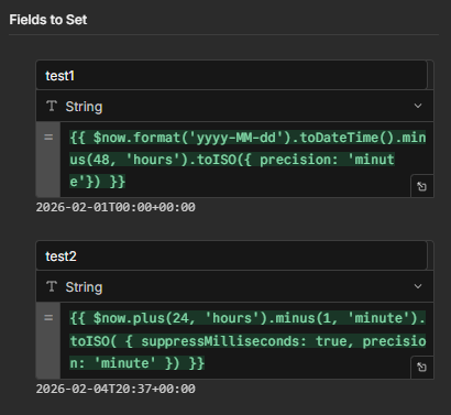

i have linked the github issue
Practically the luxon options do not work properly in expressions.

at my end the options not works as you can see on my screenshot. except if the millisecond is set on 000 in that case the options hide milliseconds, if the milliseconds is not 000 the options not work

I can reproduce the issue, but I have no idea what’s wrong :smiley:
Here on the left is my personal n8n instance v2.7.1, and it works as expected, but on the right is another instance running v2.6.3 (can’t upgrade), and it’s behaving incorrectly:
On the left, it respects the parameter; on the right, it doesn’t.

it seems solved in 2.7.5
