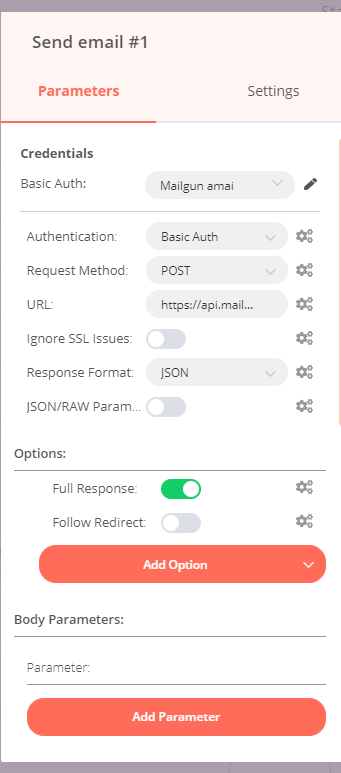

I have a mystical situation - Mailgun api(http node) is not getting some parameters on the server side.
Everything works fine, except that mailgun does not see the tagging, as i see inside mailgun:

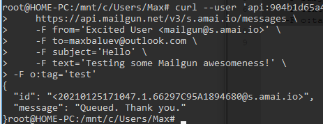

On the other hand, if you send the same data directly through the сurl, everything works fine:
How can this be and how to debug this?

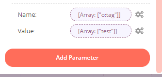

Try sending tag as an array instead. Add an expression to the o:tag value like {{["tag1"]}}
That didn’t solve my problem:

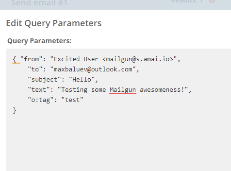

Similar error with “JSON/RAW Parameters”, o:tag ignored:

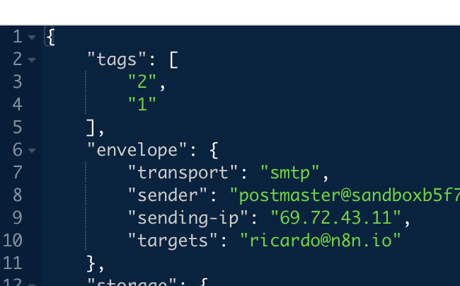

@maxbaluev Got it working by sending the data using multipart-formdata. Check the example below:

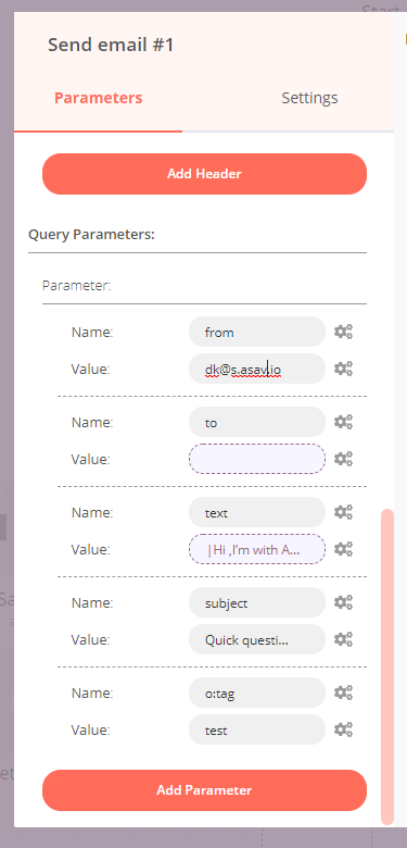

It didn’t work for me. The result is the same as it was. Did you test this with mailgun and did the tag appear?
Thank you! My mistake, I used query parameters instead of body in the last case.
Ahh cool. Glad that it finally worked.
