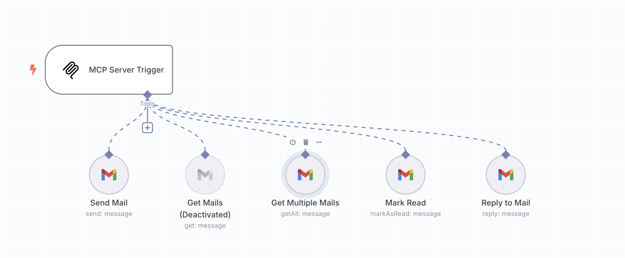

I am building an MCP server to manage my mails via Gmail. Should not be that difficult. However, when I want to extract my “most recent unread mail” it returns mails seemingly at random, sometimes even from my sent mails. How can I adjust the filtering for this?
Can you provide your workflow to understand the context and setup you are using?

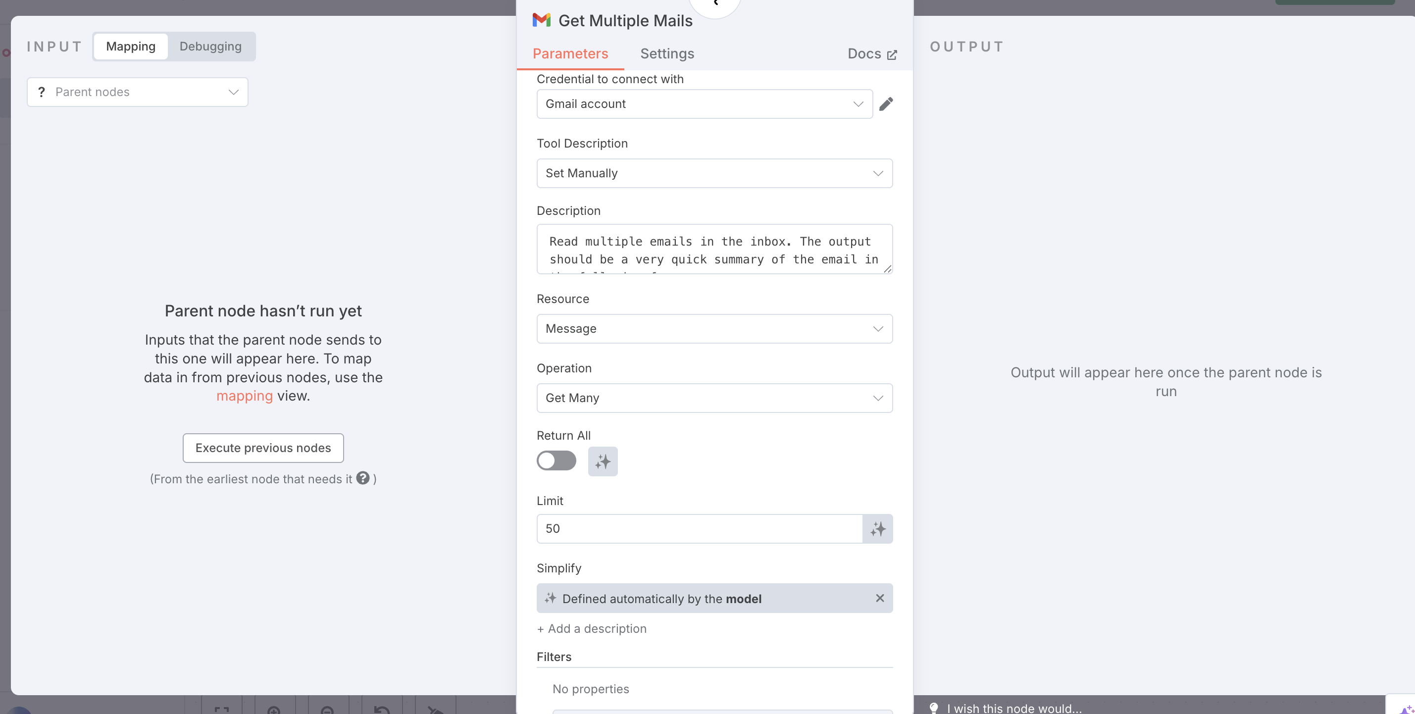

Sure, here are the flows I am using and the node that gets triggered when I ask for unread emails. The output of it is my 50 most recent emails both in and outbox, and the selected response is a random email usually :confused:
You will have to add a filter for unread most likely. What you describe makes sense for the setup.
Gotcha, works better now! :smiley: Thank you.
