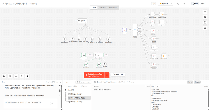

I recently migrated Qwen 3.5 9B to a vLLM Docker instance. Previously, I implemented an MCP server that worked perfectly with OpenWebUI.
However, when I try to use this MCP directly in n8n (configuring the “OpenAI Chat Model” to point to my vLLM instance), it fails. Interestingly, the same setup works fine when hosting the model via Ollama or directly through OpenWebUI.
The error output I receive is:
<tool_call>\n<function=sub_rechercher_employe>\n<parameter=Nom>\nDoe\n\n<parameter=Prenom>\nJohn\n\n\n</tool_call>
Do you have any ideas on how to properly configure n8n to handle MCP and vLLM models?

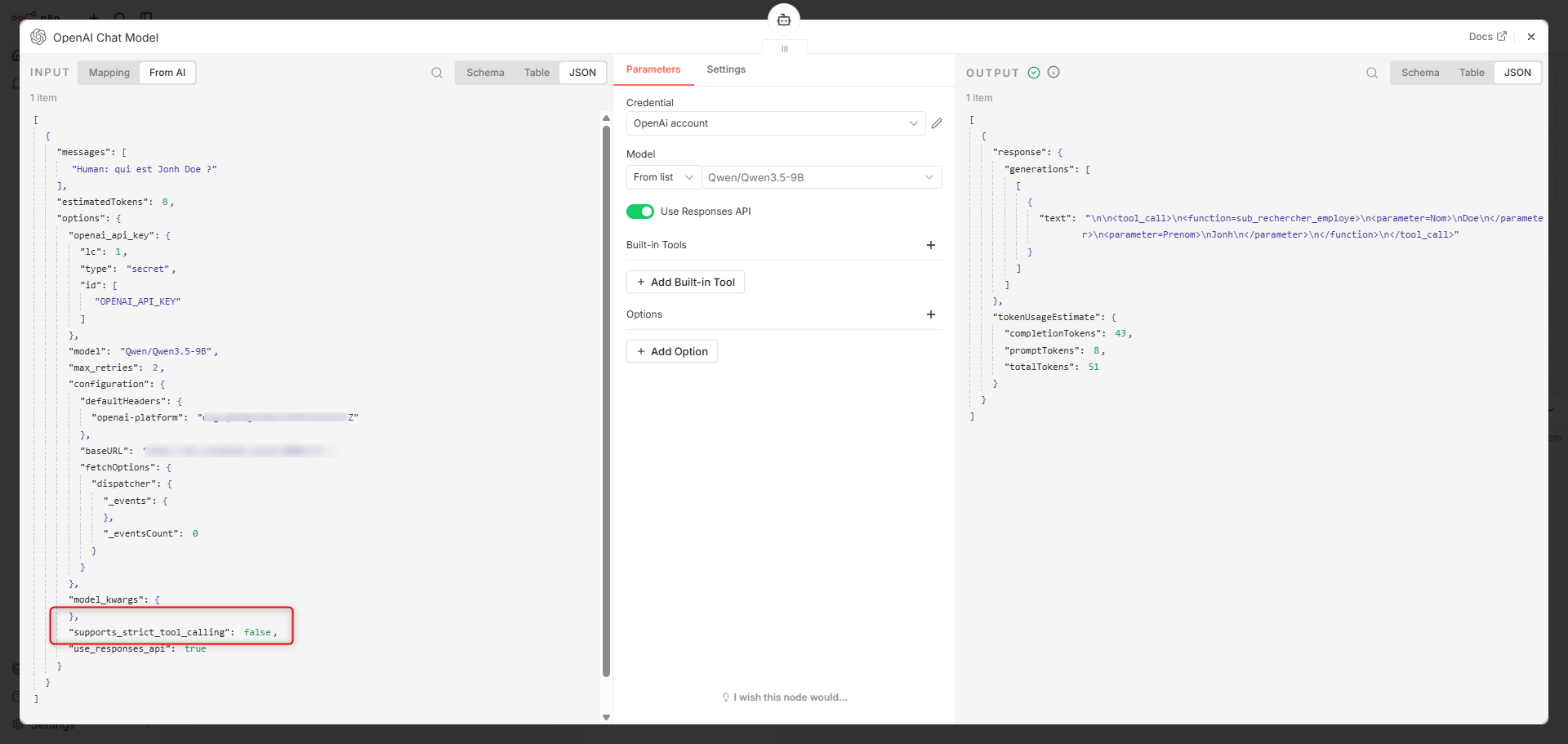

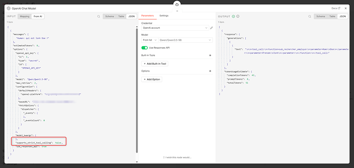

yeah, sure :
What is the parameter highlighted in red?
That means the model does not support strict tool calling. So n8n cannot fully rely on it to return proper structured tool_calls, which matches the behavior you’re seeing.
Not clear for my point of view. So why it works fine when I use the model and MCP on OpenWebUi :thinking:
