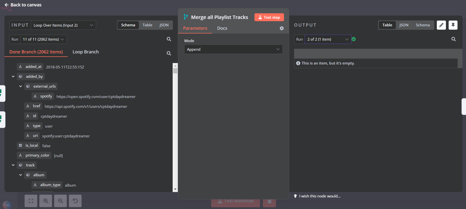

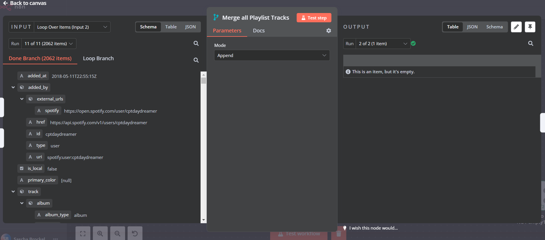

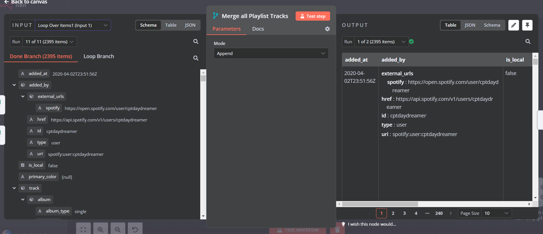

You can see the node in the middle “Merge all Playlist Tracks”. The first one contains 2395 items and the second one has 2062 items after looping 11 times. So there should be 4457 items after append but there are just 2396.
The one item that is added is also empty. Before I tried combine with keep everything but it had the same result. What is the problem?

Sorry. What do you mean? Yeah my first merge node looks like this with append:
The items have the exact same structure so even merge based on fields should work but it does not.

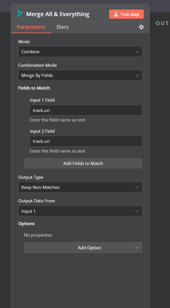

The second node:
And I also tried to do it like the second node for the first node with the output type difference.

The second one yes. I’m talking about the Merge all Playlist Tracks ones. The tracks already disappear there if you see the first image.

I guess you can call it zipper together. I just want to merge two lists to one big list in the first merge node (the append one). I also tried combine with merge by fields and keep everything like in the node after that. You can click on it. But it had the same effect instead of append.
I’ve been considering trying n8n with my Spotify, so I duplicated your macro and tested it for myself. I was able to get the Merge to work just fine. Which version of n8n are you using? Mine is 1.28.0. Screenshot below showing the exact same node results as your screenshot a few replies back.
I’m confused that it works for you. Then it should also for me. I’m on version 1.27.2. I guess I have the latest Docker one but if you have a newer one I have to check.

First loop and somehow I have also 2 runs on the merge node. You only seem to have one.
Second loop and second run:
Why 2 runs??? and why so wrong
