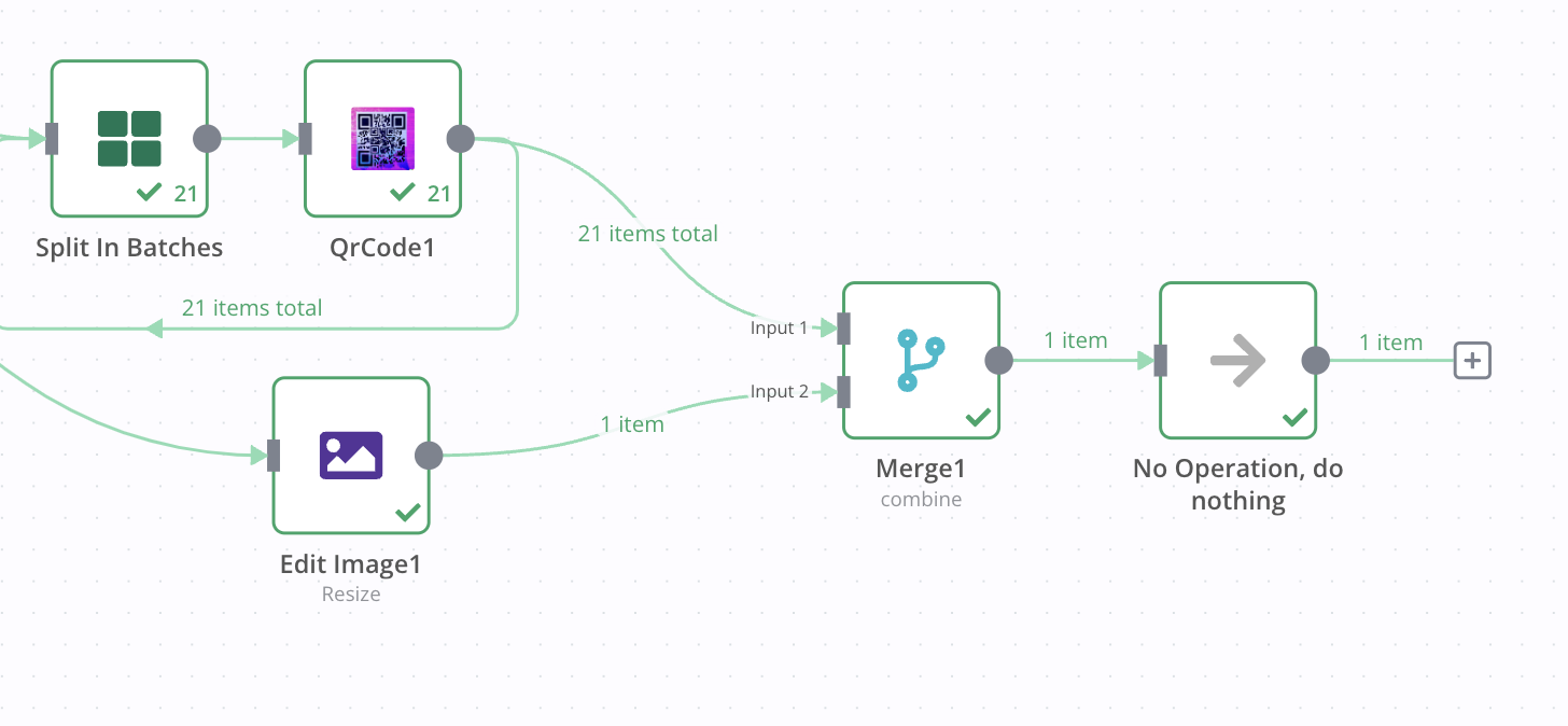

Merge data with x multiple input (input 1) will not execute x times the workflow after
Hi everyone,
I have the following workflow which when executed will execute 1 time the nodes after the merge, I want it to execute it the same times as the node in input 1
Please share the workflow
  • n8n version: 0.213.0
  • Running n8n via [Docker, npm, n8n.cloud, desktop app]: Docker
Hope you can help me with this “extract” of my workflow
Thanks in advance
Ok, it seems to only do it once because an entry only has one item
I am going to do a duplicate solution with some code but is there any solution for it to execute with the highest number of input?
Hey @0xtlt,
What happens if you swap the inputs does that change anything?
