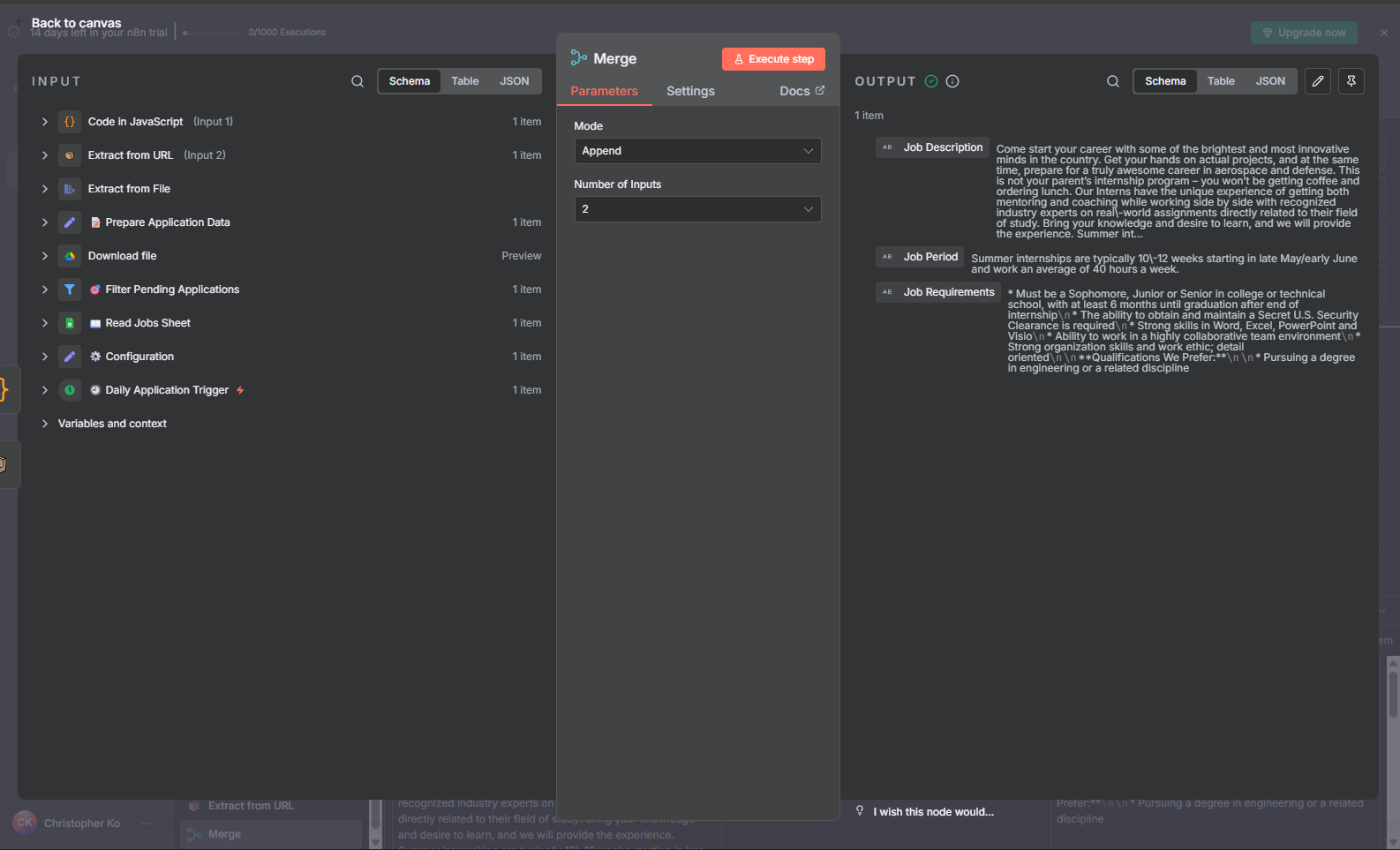

I’m trying to combine two inputs; however, the merge node only outputs one of them. I am sure that they both contain data because I pinned them. I also know the data is being passed because if I take away one of them, the other one (the one that doesn’t merge) is the only output. I assumed it might have been because one of them contained a JSON list, but after filtering it with JavaScript, the issue persists. I asked the AI assistant multiple times but it only says it’s unexpected behavior and to re-check the same things.

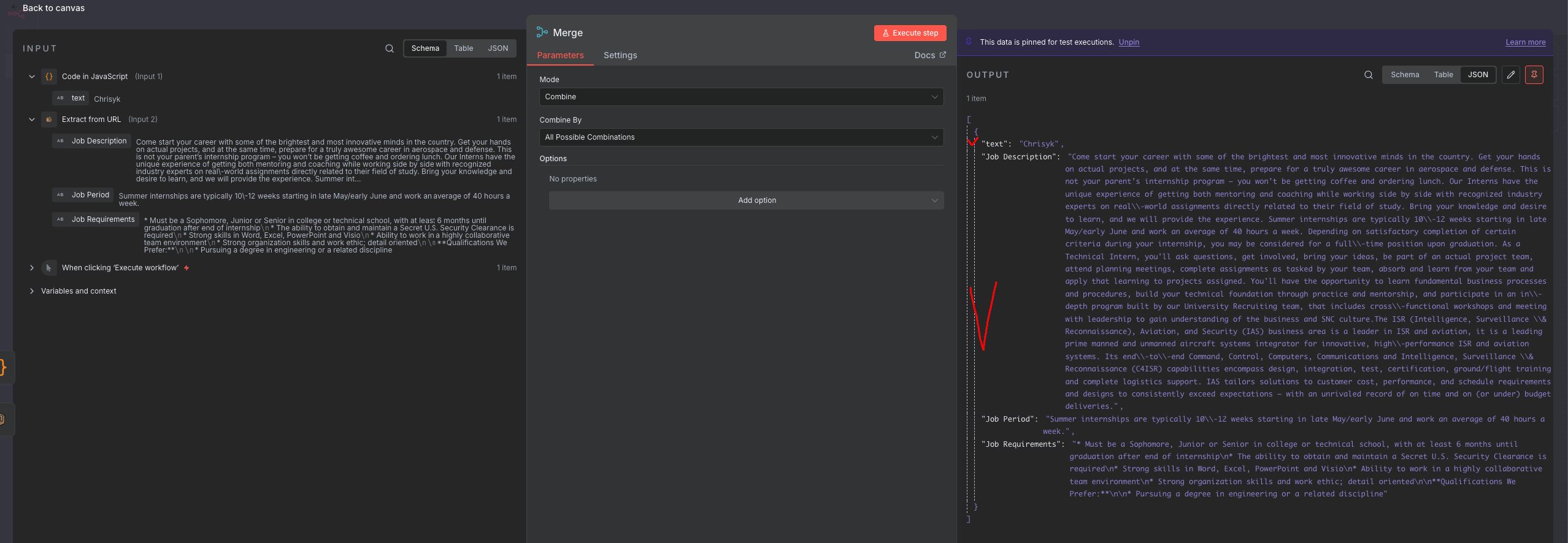

Try to change the mode to Combine (by all possible combinations) and see if that helps.
Hi @jabbson,
When I do that I get no output unfortunately.

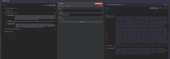

Okay, I added some redundancy so you can actually see the data.
When I run your example, I do see merged output
This is strange, could it be the input 1 that I changed? I tried it again and it didn’t work on my end.
