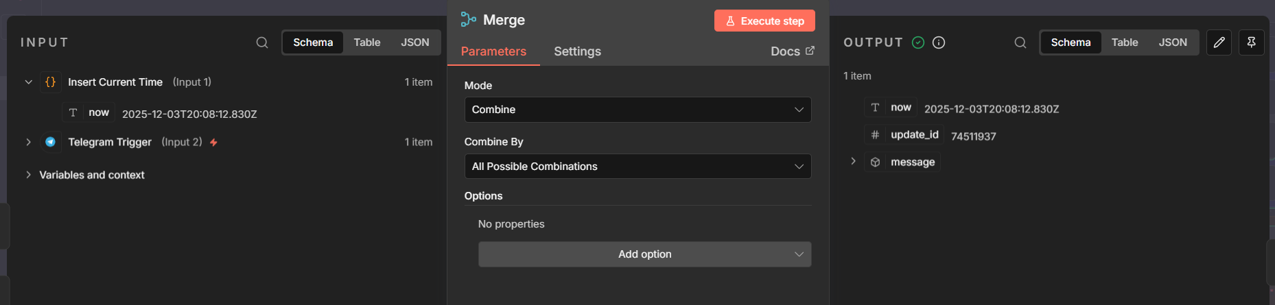

Can you show the Merge Node with pinned data? (see example)
More than likely, one of your inputs is NULL
Also, you can force the Merge Node process input to output. Use Always Output Data, in Merge Node settings.
