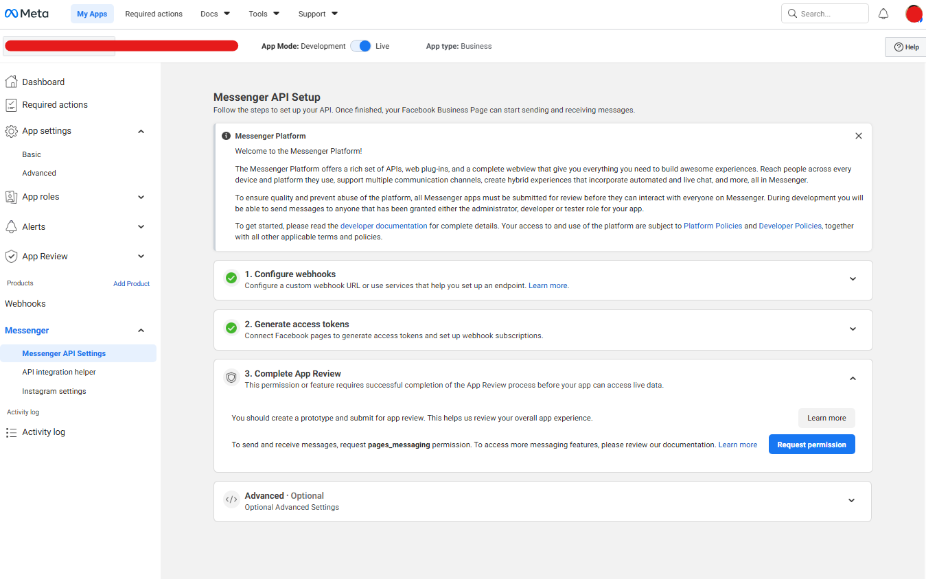

I’ve configured Meta Developers Messenger API with n8n and it has been working so far, but now for some reason although everything is live and in production, the n8n won’t trigger. Is it the Messenger’ API’s fault? Because when I try Test Webhook URL of n8n to Meta, it receives it. But when I switch to production, n8n won’t receive it.
My app was running just about last month with the permissions only using messages and messages_reads, so I guess the problem is due to this change as I initially suspected. I just hoped it wasn’t the case as the app review process was a little tedious, but I guess I have to comply. As for the Meta dashboard, it doesn’t show either.

I’ve double checked and reconfigured the webhooks and events and I can fairly say they aren’t the issue.
Does me being the administrator and owner still matter regarding the non-expiring tokens? If so where can I configure them?
Also, this app actually is meant to be a chatbot for a page, so I’m unsure if it can still work without the app review (just as they were working before). I am hoping so, as it is super meticulous.
