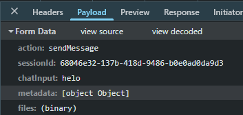

The problem becomes if in addition I allow to send files by adding “allowFileUploads: true” inside the createChat script.
When a file is sent, the metadata is not serialized correctly to JSON, and it simply becomes [object Object]. This is an example Payload sent to n8n
action: sendMessage
sessionId: 68046e32-137b-418d-9486-b0e0ad0da9d3
chatInput: helo
metadata: [object Object]
files: (binary)

The problem was that initially the request had a header of “Content-Type’: ‘application/json’” which obviously doesnt work if you are sending a file.
Solution is to remove that header.
Now the metadata has to be converted manually to json, e.g:
metadata: JSON.stringify({
‘user_id’: etc etc
from n8n side, the webhook did not recognized the metadata as Json. I had to add an intermediate set node to parse it, e.g. {{ JSON.parse($json.metadata) }}
