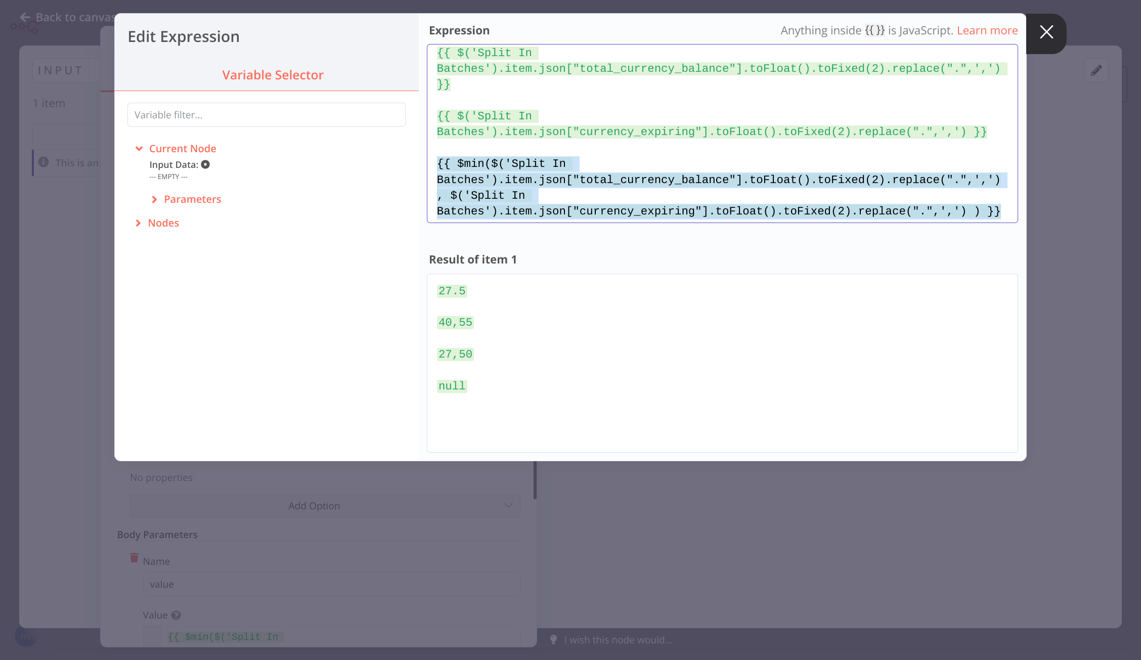

{{ $min( {{ $(‘Split In Batches’).item.json[“total_currency_balance”]}},{{ $(‘Split In Batches’).item.json[“currency_expiring”] }} ) }} returns invalid syntax
Any idea of what I am doing wrong?

Double brackets inside other double brackets won’t work. Try this:
{{ $min($('Split In Batches').item.json.total_currency_balance, $('Split In Batches').item.json.currency_expiring) }}

The solution works:
In this example, it returns the value “27.5”, which is correct.
However, i need to send “27,50” in the next node (currency format outside US, with comma instead of period and 2 decimals).
I tried to insert .toFloat().toFixed(2).replace(“.”,‘,’), which works outside the $min(), but returns null here:
{{ $min($(‘Split In Batches’).item.json[“total_currency_balance”].toFloat().toFixed(2).replace(“.”,‘,’)
, $(‘Split In Batches’).item.json[“currency_expiring”].toFloat().toFixed(2).replace(“.”,‘,’) ) }}
Any suggestions?
