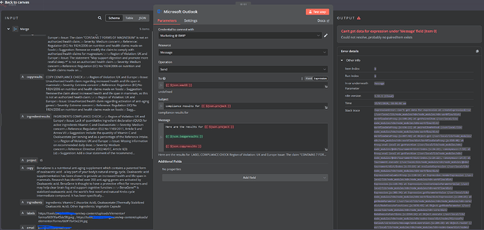

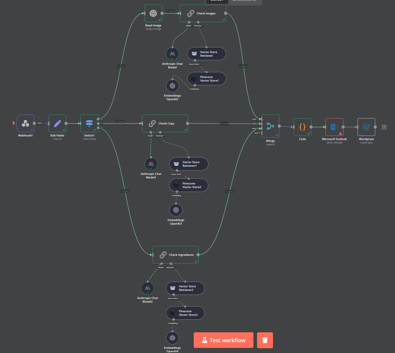

I have made a couple of changes to try clean up the expressions, and pass the project name and email to the end of the flow (via a switch and a merge), but still the same problem. Here is the current updated flow
@aya
Here is the screen shot of the error I am seeing too:
As you can see, only one field is being picked up (imageresults), the others are showing as empty, even though the input clearly shows they exist and have data.
Am I missing something really obvious?
Thanks :slight_smile:

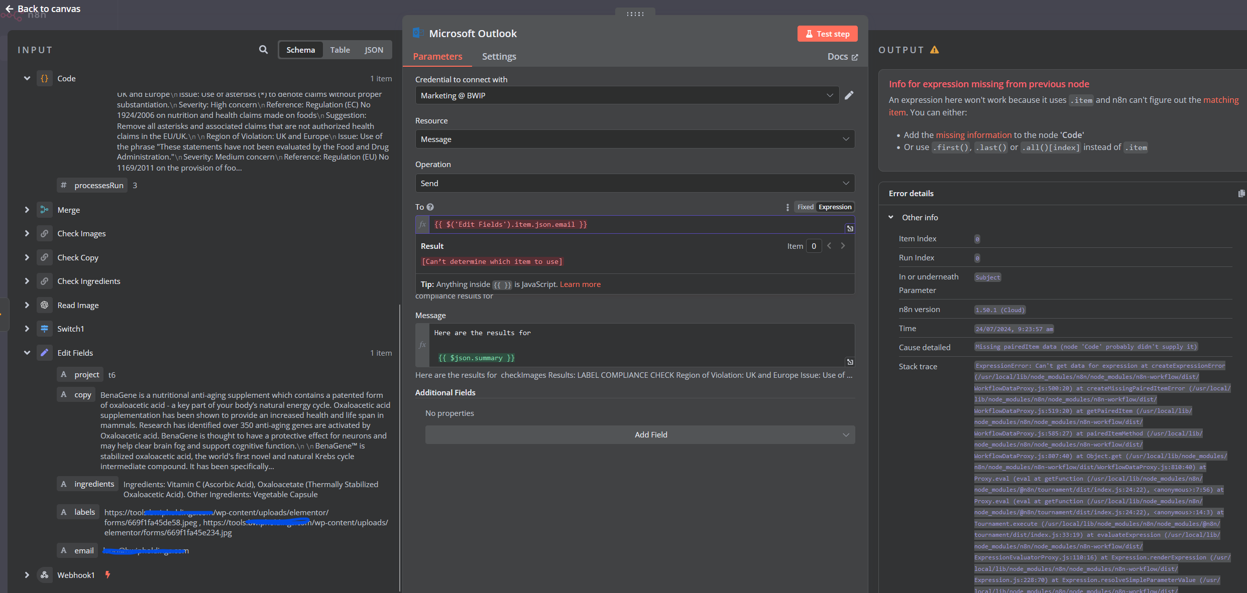

I see on the first screen that you have a Code node between Merge and Outlook. But on the last screen you are showing the output of the Merge node.
$json property can refer only to the items of the previous node.
As you have Merge node in Append mode, you can’t refer to the previous nodes with $(<nodename>).item.json property, you can only refer via $(<nodename>).last().json, $(<nodename>).first().json or $(<nodename>).all() methods

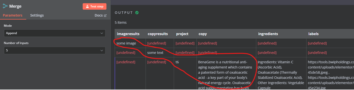

Thanks @barn4k for the input, but unfortunately I don’t think that is the entire issue. I have tested the fields from multiple nodes, and that may not have been the best screenshot to share.
As you can see below, one field from the previous node worked fine (that was also a merge), others did not. And one from a defined earlier node is also not working:

That’s the issue
Your Merge node works in Append mode and as you have 5 inputs, you will receive 5 items in the output. You should use the Combine Mode (by position) instead.
@barn4k - thanks! A massive help. Much appreciated :slight_smile:
