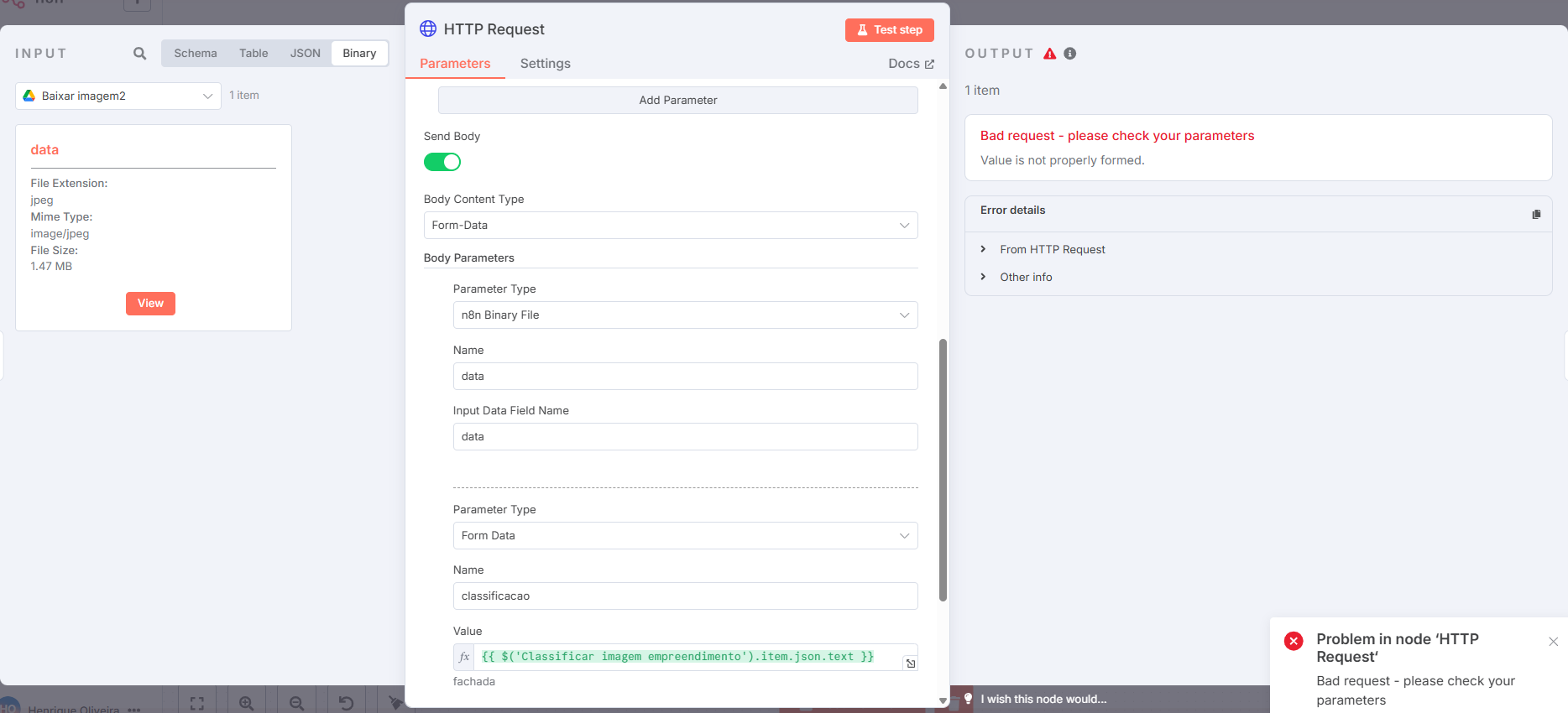

Hello again,
I tried calling the API directly from my backend and also using Postman. In both cases it worked perfectly. I also reproduced the same parameters inside n8n and it keeps returning errors (a different one by the way).
Error code
400
Full message
400 - "{\"code\":\"ERROR_CODE_INPUT_ERROR\",\"message\":\"Value is not properly formed.\",\"payload\":{\"param\":\"image_uploaded\"}}"
Request
{ "headers": { "accept": "application/json,text/html,application/xhtml+xml,application/xml,text/*;q=0.9, image/*;q=0.8, */*;q=0.7", "content-type": "multipart/form-data; boundary=--------------------------890540274835140049371507" }, "method": "POST", "uri": "https://XXXX.xano.io", "gzip": true, "rejectUnauthorized": true, "followRedirect": true, "resolveWithFullResponse": true, "followAllRedirects": true, "timeout": 300000, "formData": { "_overheadLength": 250, "_valueLength": 1100722, "_valuesToMeasure": [], "writable": false, "readable": true, "dataSize": 0, "maxDataSize": 2097152, "pauseStreams": true, "_released": true, "_streams": [], "_currentStream": null, "_insideLoop": false, "_pendingNext": false, "_boundary": "--------------------------890540274835140049371507", "_events": {}, "_eventsCount": 3 }, "encoding": null, "json": false, "useStream": true }
