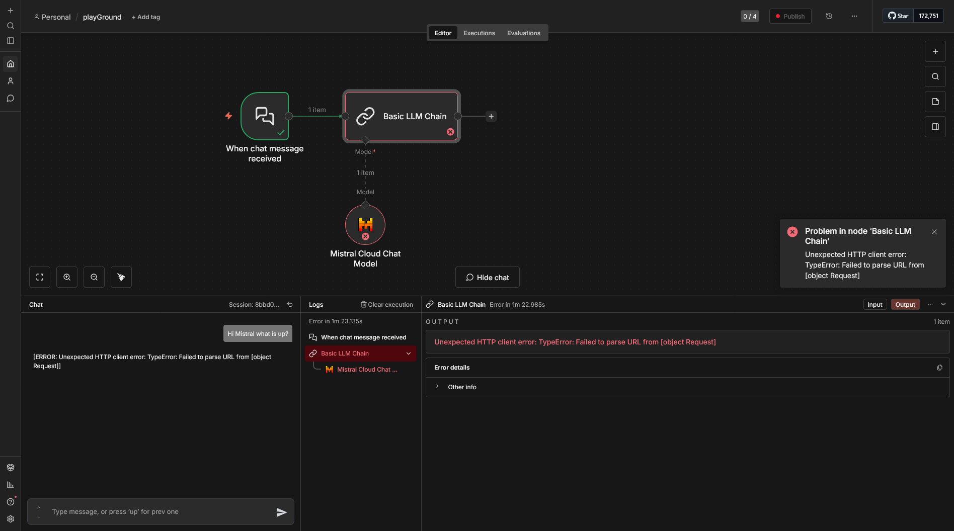

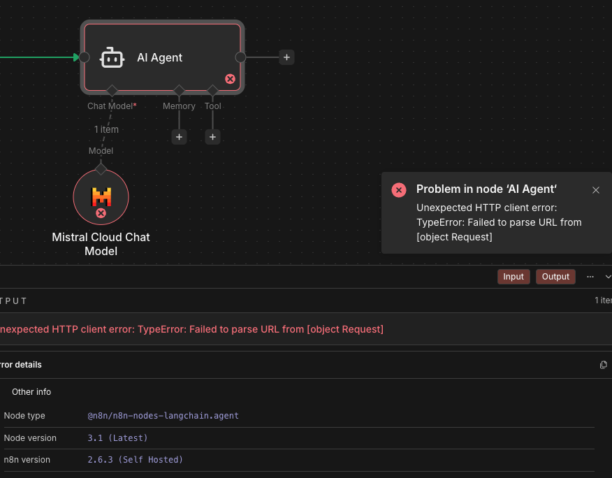

When running an agent with mistral the agent fails after about a minute with the below message. This happened after the latest update today.
I didn’t change the workflow and tried new workflow, new agent, different deployment (local/cloud)
I just downgraded my local version to 2.4.8 and mistral works again with the agent.
Unexpected HTTP client error: TypeError: Failed to parse URL from [object Request]
Just the agent and mistral node.
  • n8n version: 2.6.3
  • Running n8n via n8n cloud:
  • Operating system: MacOS Tahoe

This does look like a regression introduced after 2.4.8, and similar reports are starting to surface.

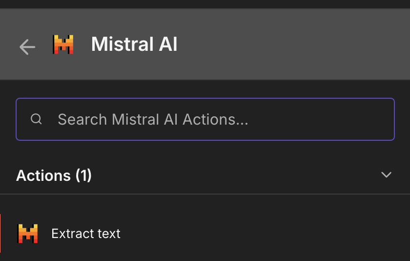

Mistral has no standalone chat node. It only works with the agent (see screenshot).

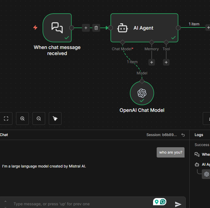

Yes, the agent works with OpenAI and Google successfully.

I never have used Mistral model until now when i created an account and added billings and when got the API keys i brought them to n8n and created credentials everything upto that level seems fine until i attached mistral model to the llm chain and it gave me the same error, i have tried multiple times, i guess temporary workaround is just to use another service provider, and yeah it is worth mentioning that when i have tried Openrouter/Groq and accessed Mistral model via there services everything worked really well, i guess this is a genuine issue. Hope this helps! Please dont consider these AI spammers, they do not even touch the grass when replying to the question with AI.

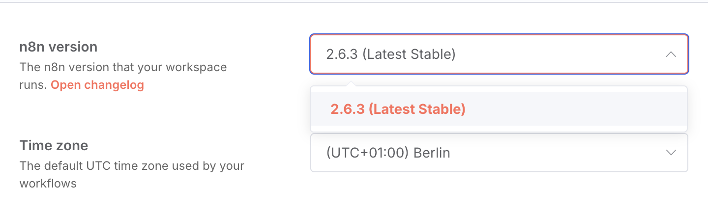

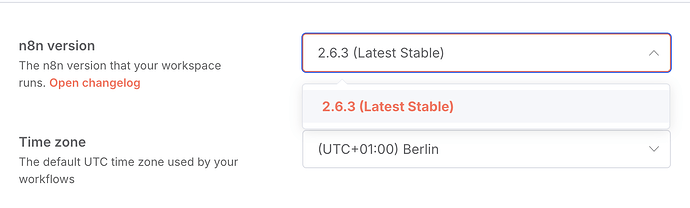

@tamy.santos do you know by any chance how I can downgrade my cloud workspace?
It is processing 200 pages of PDF for a client daily which now came to a halt :grimacing:
@Captain-AI
If you’re the owner, you can change the Cloud version directly from the Admin Dashboard in your Cloud dashboard.
Cloud dashboard.
[Update cloud]

  • I am the owner, but cannot downgrade the cloud version.

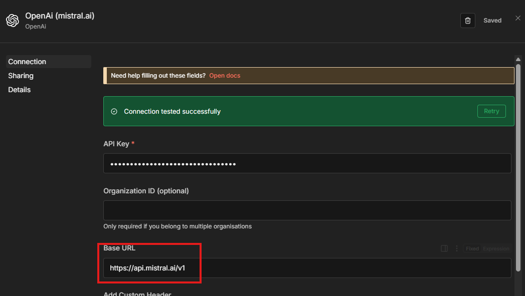

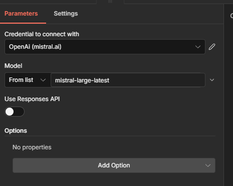

It seems like a bug to me,
Anyway, until it gets fixed the current workaround is to use OpenAI credentials and connect via the OpenAI node, It’s stable…
Base URL:
https://api.mistral.ai/v1
