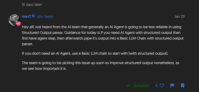

In Post 2. it was recommended to use Output Parser with LLM Chain and not in the AI ​​Agent.
What is N8N’s guideline on this?
Should we not use Output Parser with AI Agent, is it still unstable?

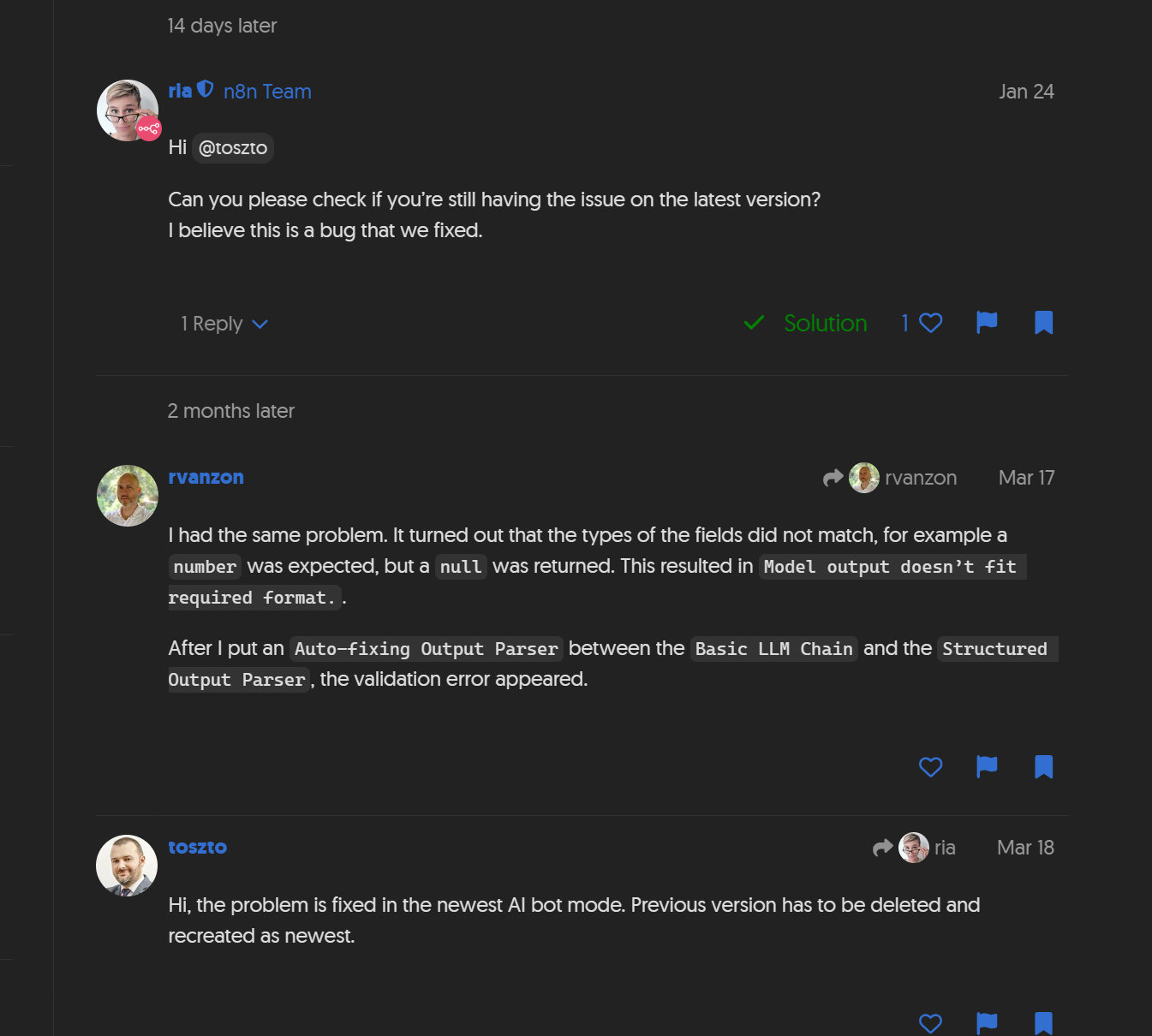

Hi, in my case the problem was that if agent had wrong format output on the first try, then the whole request failed even if it corrected the output on the retry. Any correct retry was ignored and there was next until max number of retries and whole output was failed. They fixed that. There is no guarantee that an agent would prepare the output in correct format. That depends on the prompt and the LLM model you use. IMO it’s n8n independent issue. The best you can do is take it into account and 1) simplyfy the output so it’s easier to prepare it valid 2) experiment with the prompt so the agent has straightforward criteria to build the output, and 3) retry failed attempts and monitor your agent success ratio so it doesn’t burn to much tokens failing.
