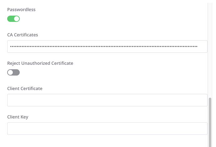

Sorry Jon - I’m not seeing any option to toggle certificate errors. Where is that?
Looking at it again the default is false and the name is somewhat misleading but what do you have “Reject Unauthorized Certificate” set to in the credential?
I have to enable the “passwordless” option to see that:
It does look to be disabled by default.

I feel a bit silly now but I have managed to get it work, Can you make sure the protocol is set to Mqtts then use the SSL port which for my instance was 25702 then enable SSL, Passwordless to disabled and don’t set a CA Certificate.
Not as silly as I feel. I swear I had tried that configuration…but I must not have. Maybe I didn’t have mqtts selected.
Thank you. :pray:
