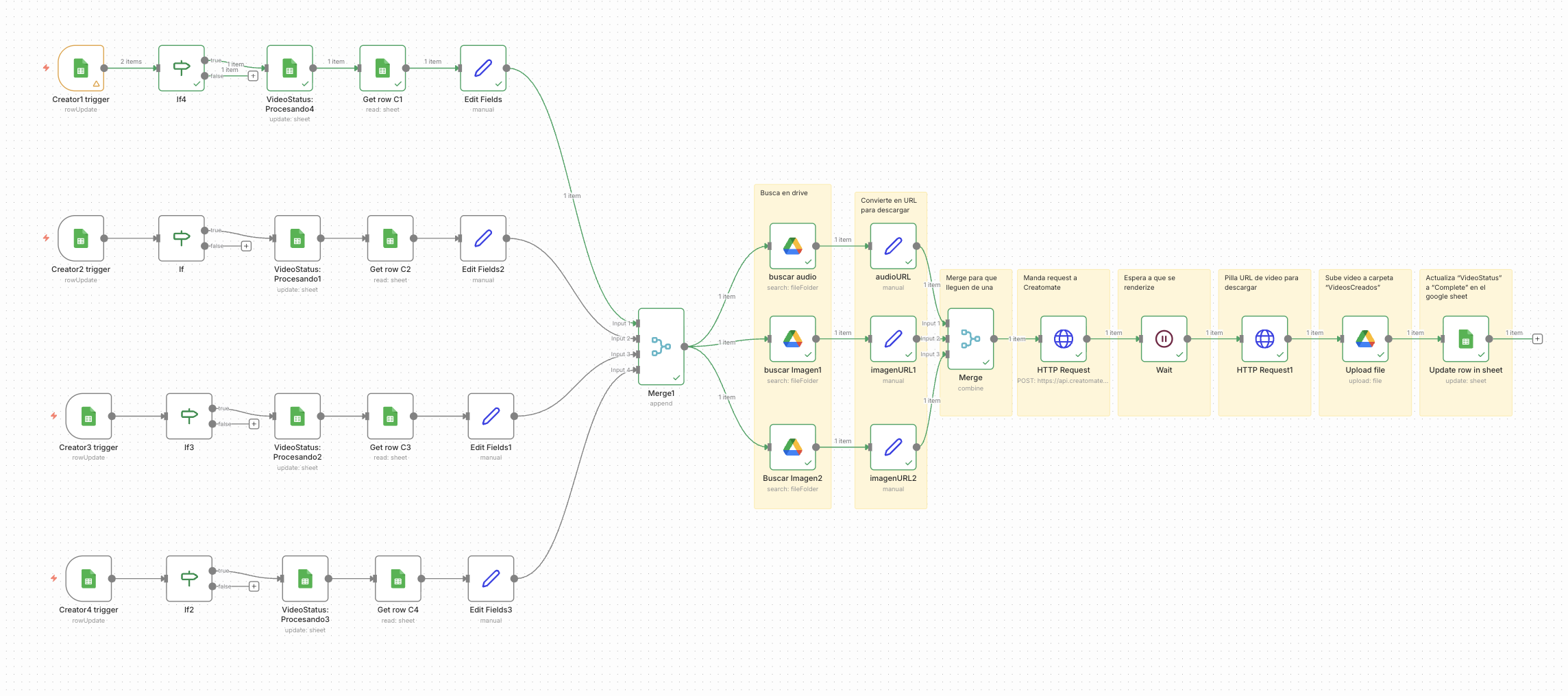

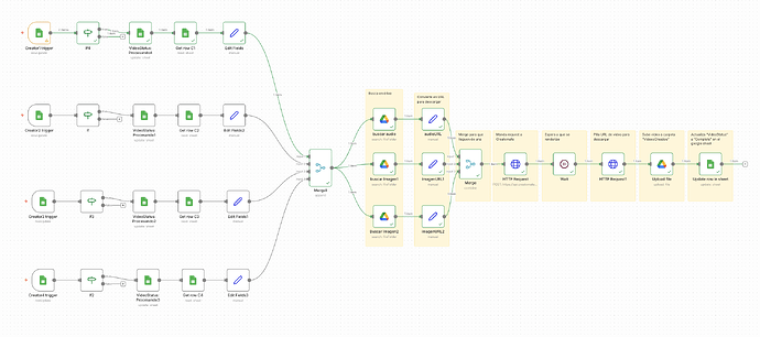

i struggled so much to upload this :sweat_smile: . thing is sometime it works sometimes it doesnt. it always works when executing manually. i have no idea whats going on
You are watching Ejecutar column. Are you updating that column when your trigger do not get fired?
Ejecutar is filled in when we want to run the workflow. And it stays like that.
Thanks for your help! So what would you say is the problem, that it doesnt detect a new row as row updated? Meaning i should change the trigger to ‘On row added or updated’?
that depends on your use case. your trigger fires when Ejecutar column is updated currently. if you want your trigger fire on other cases change it to catch other events
