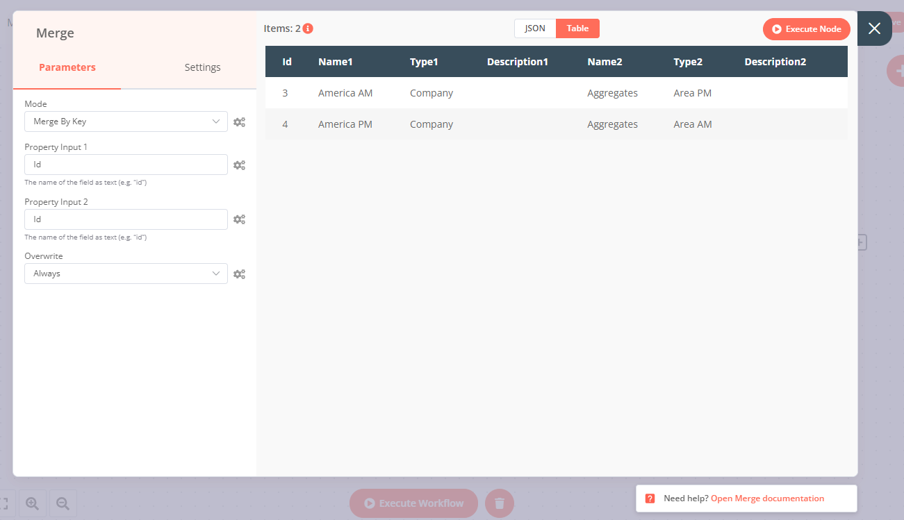

Oh I see - the Multiplex node would indeed make things more complicated in this case.
But let’s unpack this step by step. The first problem I see are the different data structures. Neither of the example outputs provided appear to be multiple n8n items which actually seems like a step back from where we previously were.
So based on my understanding (and please correct me if my assumptions are wrong at any point), this would be a three step process:
  1. First, let’s ensure that we have one n8n item per Value object as my understand is that these are the items you’d like to merge eventually.
  2. I’d then assign unique keys (field names/column headers if you like) to each field to avoid accidentally overwriting any data (I’ve just appended 1 and 2 to the existing names in my example, but you might want to pick more descriptive names on your side).
  3. Lastly, I’d merge the items based on their Id values using the Merge By Key mode of the Merge node.
Using your latest sample data this would give me two items in the end with fields from both branches (where the both items with Id 3 are merged together in one new item and both items with Id 4 are merged together in another item):
Example Workflow
