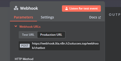

  1. When you say you “switched the webhook to “test” mode,” do you mean you toggled the display in the node dialog from production to test? Just want to be sure you understand that doesn’t do anything but show you the 2 different forms of the URL. You must activate the workflow to make the production URL available.
    Use this to turn the production URL on…
    Not this…

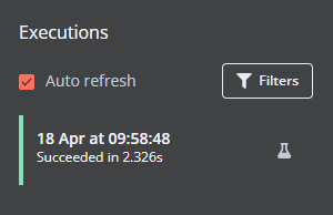

What I’m trying to explain is that only the test webhook is working, regardless of which workflow I’m using. When I use the production webhook URL in the Evolution API, no requests appear in the Executions tab.
However, when I replace it with the test webhook URL and click the “Execute Node” or “Listen for events” button in n8n, the flow runs normally and I can see the execution.
