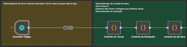

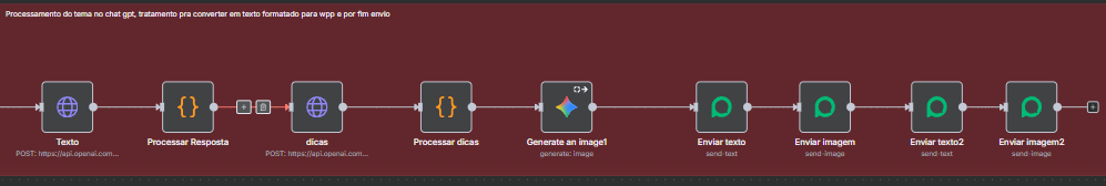

My workflow execute 1 time but send 2 messages please help
I have this workflow in n8n that I use to send messages on WhatsApp. I have two groups, and over the last week, it started sending duplicate messages to both groups. However, when I run a manual test (forcing execution or changing the schedule trigger time), it sends only one message correctly. But the next day, it starts sending two messages again

Looking at your screenshot, check if:
The Switch node is creating a loop back
Both paths execute the same WhatsApp node
To debug:
Check execution history - do you see 1 or 2 executions?
Add a “Set” node before WhatsApp with: {{ $now.toISO() }} to timestamp each run
Check if both groups are in a single array causing iteration
