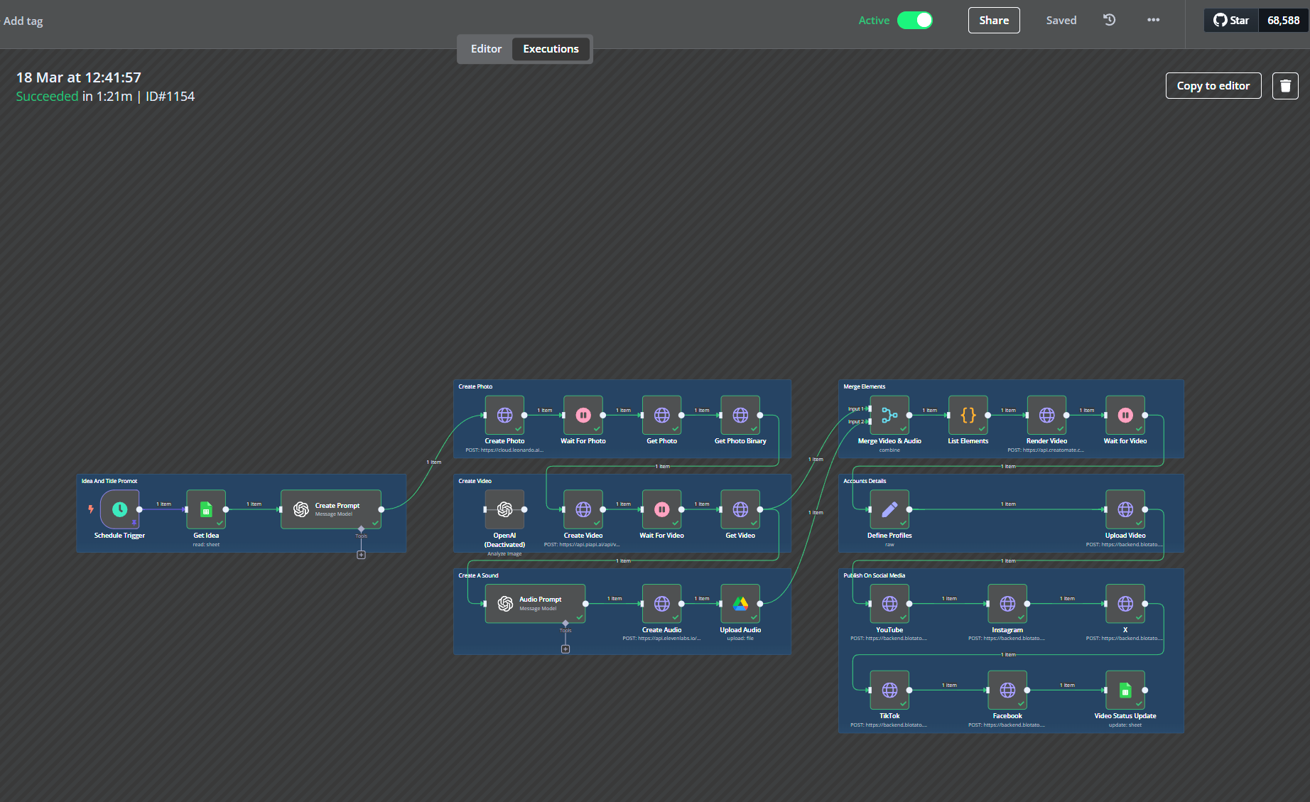

Yes. I use version 1.82.1. The problem is that when I open my workflow and press test workflow everything is good no problems. Than I have setup a schedule trigger on every hours. And than I come back after 24 hours nothing I doesn’t want to start and when I check executions also nothing just the one I was doing…

Hi, I have updated it to 1.83.2 And I still have the totally same problem. And it is for every workflow I have not just for 1.
As you can see it is active, eveyything works, no problems at all It just doesn’t want to start on its own.

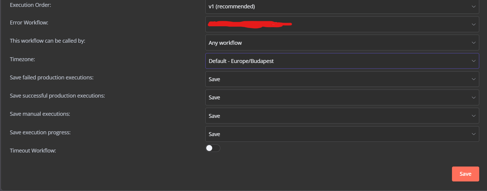

Also now I saw this this is new
