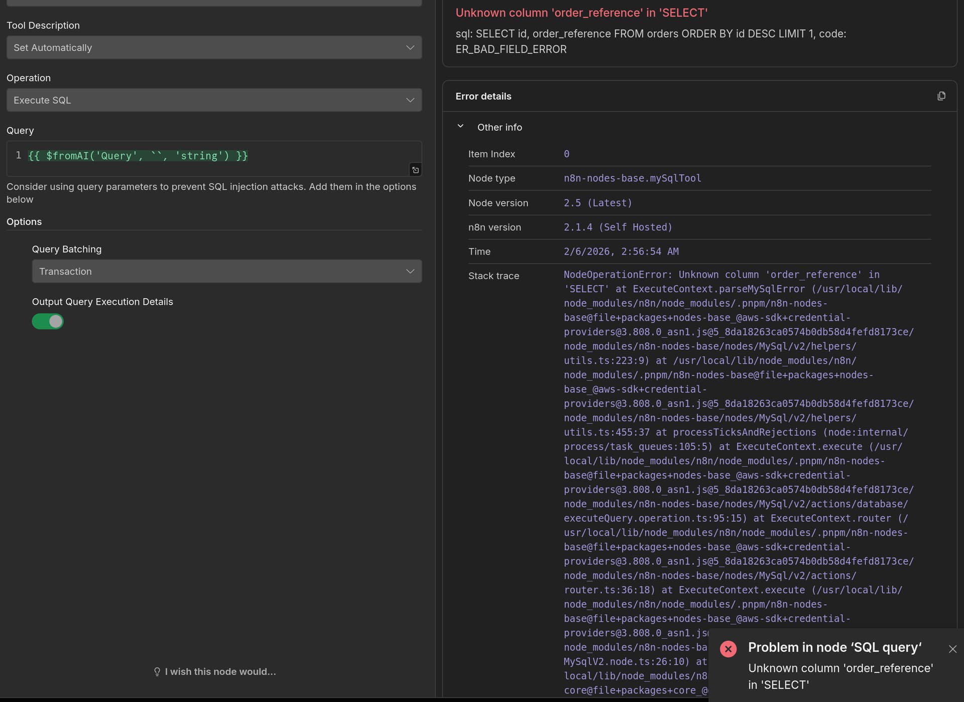

Hello, I’ve been spending some time lately playing with AI agents, however a very common issue I’m running into is with the MySQL Tool. I’m letting the AI Agent access my db with “Execute SQL” Operation, but it often fails (changing the model sometimes helps, but it’s more of a coin flip). I’m wondering if it would be possible to configure the SQL node to not error the whole scenario (stopping scenario execution) whenever a query is bad? Instead of “Error” I’d like to feed the error back to the AI agent. Is there any work planned on adding this functionality to the MySQL tool?
Hello, thank you for your answer. Unfortunately the feature you’ve mentioned is only available in the standalone node. I was referring to the tool that is connected to the AI agent node, which is almost the same, with the mentioned feature not being included :frowning:

What you need is a better design architecture, which I’ll explain below, such that your agents self-improve with mistakes. I’ll also offer a quick fix.
Quick Fix: “On Error” Node Setting
Every n8n node has a Settings tab (gear icon) with an “On Error” option. By default it’s set to “Stop Workflow” and that’s what’s killing the execution. Change it to:
“Continue Using Error Output”
This gives the MySQL node a second output branch (a red one) that emits the error message as data instead of crashing the workflow. You then route that red error output back into the AI Agent’s conversation loop so it can read the error and self-correct its query.
Wire it Properly: Agent Learns from its Mistakes
1. MySQL Node → Settings → On Error → “Continue Using Error Output”
2. Route the error output back to the agent. After the red (error) output, add a Set node that formats the error into a message like:
Your SQL query failed with this error: {{ $json.error.message }}
Please fix the query and try again. Remember to only use columns that exist in the schema.
Then loop that back into the AI Agent as a tool response.
3. Give the agent schema context upfront. The root cause here is that your AI hallucinated order_reference as a column name. Add a preliminary step (or put it in the agent’s system prompt) that runs:
SHOW COLUMNS FROM orders;
…and feeds the result to the agent. Something like:
“You have access to a MySQL database. Here are the available tables and their columns: [schema output]. Only use columns that exist in this schema. If a query fails, read the error and retry with a corrected query.”
4. Cap retries. Use a counter variable (via Set node + If node) to limit the agent to 2-3 retry attempts so a confused model doesn’t loop forever.
